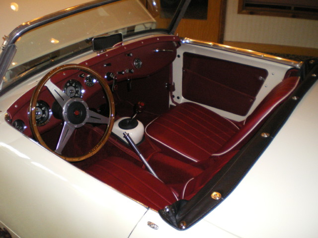

The enterior of your BE is a 10. I assume that it's leather.
My BE is English white with the red interior with white piping. Mine, however, is the vinal. Who knows leather could be next.........I guess Moss is the source.
