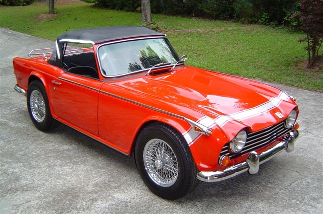

AlanT
I tried to send an image or the 2" SU's but cannot get the file under 200000 bites so I will send an image of the TR250. I will take another pic of the engine compartment when it returns from the paint shop and I can finish 'dialing it in'.
Alan T
