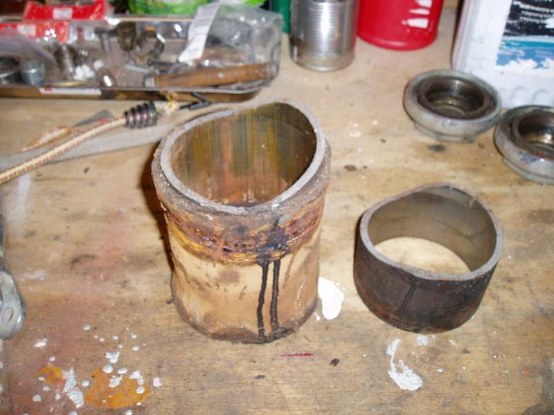

TomMull
BFH?
Actually this one came back from the machine shop with a BFP as the hammer failed. I wasn't there when it happened but I told them I was interested in saving the block, not the liners. Block is fine.
Tom
CJD
Interesting...if you knock from below, it's not obvious how the skirt could fail like that. They must have tried rocking (with a BFH) it from the top!
TomMull
Piston and rod stuck in the stuck cylinder. My guess is that they found a way to press on the rod or put a tool onto the piston. Rod came out straight and true also. Tom
