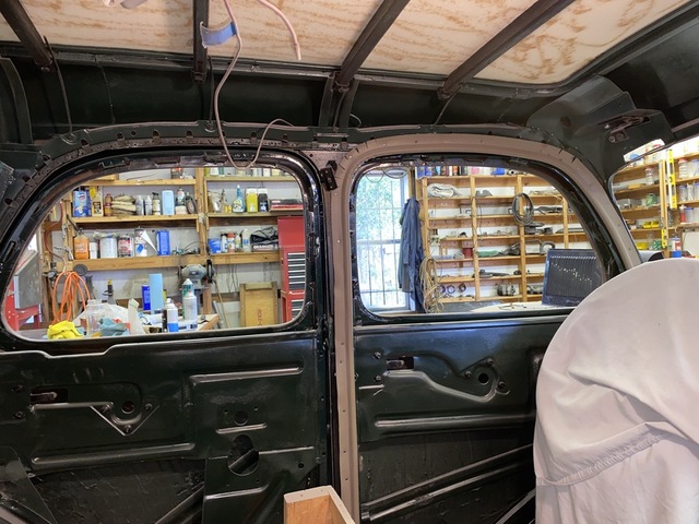

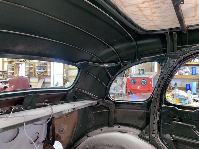

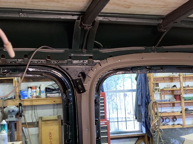

Would you mind sending me a photo of your headliner?
Thanks
Bayless
Can't do that. I haven't built it yet. I think I can get a photo of the bows though. We had a minor crisis at the shop today and I didn't get time to look in the Prefect but will try again over the weekend.
Bayless
Well I did go back to the shop and got these photos. One shows the wood top bows with the wire stubs below them. You should see where the wires attach on your car. Another is a detail of the wire stub attachment. Finally I have one of the three full wire bows at the back plus the stubs that end at the rear window. That makes a total of 8 bows, counting the stubs at the back window. Below those last stubs is a nailing strip where the headliner finishes. There is a nailing strip above the doors and the front has a hard panel that covers the attachment, also headliner material.

I wonder why they did not run the bows full length at the hole or whatever you call it in fact I do not understand why they made the soft top. I thank you as it really helps thank you
JimG
Bayless
Remember, your car is just a facelift version of my '48 which was actually introduced in '39. That's how a lot of cars were made in the '30s. It was probably more difficult and expensive to form a fully steel top. Our shop is just about finished restoring a Model A and its top is quite similar although longer so there are no wire bows. Also, they omitted the short wires along the sides and just dropped straight from the wood top bow to the side. I understand the Australian version, which was introduced later, has a full steel top. Don't know if it is one piece though.
