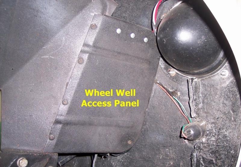

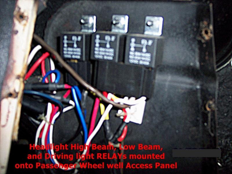

With the installation of an alternator, I upgraded my headlights quite a while ago and used relays to allow my relatively thin wired original harness to be used for switching only and, in fact, have a lower overall amperage draw. When looking for higher lighting output, LED headlights were not an option and the amperage draw of the new sealed beams was quite a bit greater. To address this issue, I employed 3 relays (headlights and driving lights) and created new higher gauge wiring harnesses to pass the power from relay to lamps. Installation of the 3-relays for both headlights and driving lights was on the inside of the right side wheel well cover with a fused line to a direct alternator takeoff.
Although I do appreciate the use of modern technology to improve Healey operational reliability and safety, I have tried to keep the original look a much as possible. Since I no longer use my Healey for evening drives, the LEDs could prove advantageous when driving with headlights on during the day (as is my practice). However, I would not convert to LEDs if their appearance would diminish the era-look of my Healey.
