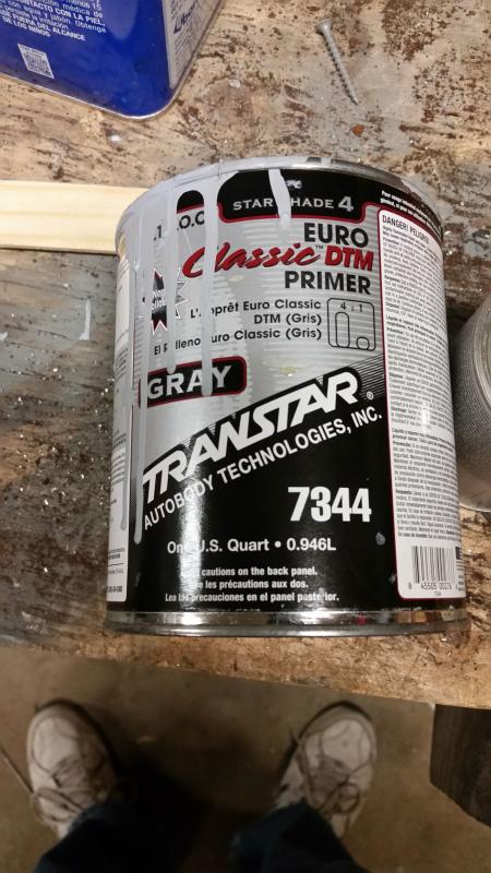

This is the primer I used on my TR3A
It is a 2 part primer. Went on easily.
David
