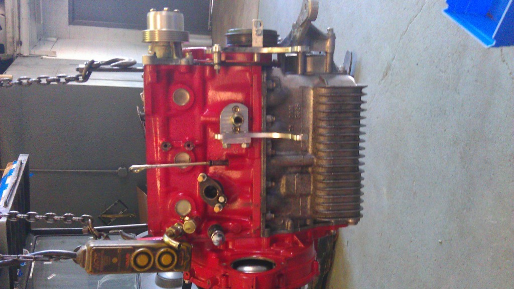

The Cooper-S engine is probably sitting on a remote shift gearbox. Since it sounds like you are going with the rod change with the 1380 don't forget that you must add extra engine steadies to support the engine and gearbox. I think with your early shell there is also an adapter bracket required to fit the rod change to the floorpan. If I remember this correctly, there are also issues when fitting certain exhaust systems when you make the switch to a rod-change box in a car with the early floorpan. This is another thing I would ask about at MM if you don't get enough eyes on it here.
Would-be buyers for Cooper-S engines can be brutal. Before they buy an expensive -S engine they are going to want to know it runs. Therefore, you may want to at least temporarily fit it to your car and drive it for a time so you can say confidently that you know it works and does not have issues. Perform a compression test and keep the numbers for reference along with the operating oil pressure when hot. Even though it is an -S engine, you will find people want it discounted if you cannot guarantee it is in good condition.

I talked to Smurf at the other forum and he has been trying to sell rebuilt engines. He thought it was not productive to rebuild but to sell it as a block. His questions since he has done many Cooper S, was to make sure there are not sleaves installed in the block. Then it would be easy to bore to whatever the buyer wants. I know the PO drove the car but the compression sucks and the pistons are original by the markings. Since two of them have the arrows now pointed in the wrong direction, I assume they put new rings in. The head has been rebuilt based on the valves and seals. I am going to have to steal some parts off it anyway. The engine mounting brackets.

Missing the tach drive? I am misunderstanding something. There is no tach drive on a standard Mini engine. Some very rare modifications were sometimes done to fit a mechanical tach drive kit through the timing cover but those are not stock and are very rare. The common tach is electrical and the early cars did not come with them (not even the Cooper or -S).
Smurf would know more about the engine market than I would. I was basing my comments only on threads I followed over recent years. Whether it is justified or not, an -S engine can fetch more in parts than it does as a whole unless the engine condition is "known good". The original Cooper -S crank at stock grind with an undamaged tail for the flywheel is probably the most valuable component followed by the block itself. The early AEG163 head can be valuable but that all depends on condition and the would-be buyer's desire for originality. I have my car's original head in the attic and chose to recondition and fit a later 12G940 head instead as they are less prone to cracking.
A block with sleeves may not be desirable for larger offset boring like your 1380 but if the sleeves are at the stock diameter then there is a lot of life left in the engine. Sleeves would not scare me away from buying an -S block.
The gearox presents options for you. With the proper drop gears you could use your existing remote shift box under the 1380. That would allow you to use the standard engine and gearbox mounts and avoid fit problems with the exhaust pipe and the floorpan tunnel. Another part you may have to change if you fit the rod shift will be the driveshafts. The remote shifts used either yoke & cross outputs or Hardy-Spicer. The rod shifts had "pot joints" (basically an inner CV joint). However, parts sof the early 3-synchro remote shift are hard to find and you may not want to use it with a daily driver. If you have a 4-synchro remote, parts for those are a bit more available. Parts for the rod shift are readily available.
The 26 stamped on the head is probably the chamber volume in CC and that does sound a bit low. You said the compression was "low" but what is it and how uniform is it across the cylinders? I don't remember the volume of my car's combustion chambers but I think it was something between 21 and 22 cc.

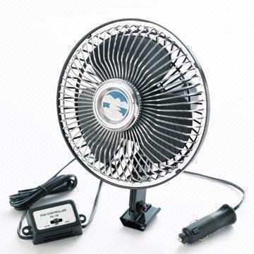

Good to know about the heat in the sliding windows, Smurf said the same thing. What we need is a totally electric air conditioner. Maybe I can steal the one out of my wife's Prius?

I installed an oscillating 12V fan upside-down to the underside of the parcel shelf above the passenger footwell. It is pointed towards me and I don't use the oscillating mode. It makes a big difference in "comfort" on hot days.
