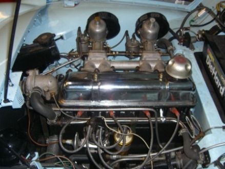

Well I am starting to get the bugs out of this tr3 project and I am struggling with what sounds like a lifter. The noise is not extreme only irritating and un- perfect. The engine performs better than I thought it would. Anyway I had the lifters and the tappet ends machined, so I do not think the noise is a dishing problem. I used old push rods and perhaps one of those is egged shaped on an end. I cannot seem to isolate the exact lifter. I tried a stethoscope (hp) and a rubber hose, but still no joy. Perhaps the noise is something else. It sounds clackie though, so I do not think it is the crank trust washers. It sounds like a mild lifter. Any ideas on how to isolate are very welcome.
