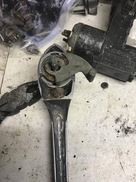

First of all, Here is what it starts with - there is a circlip type spring holding everything in - you can sort of see it at the tops of the picture. Not circlip holes so lever it out with a small screwdriver.

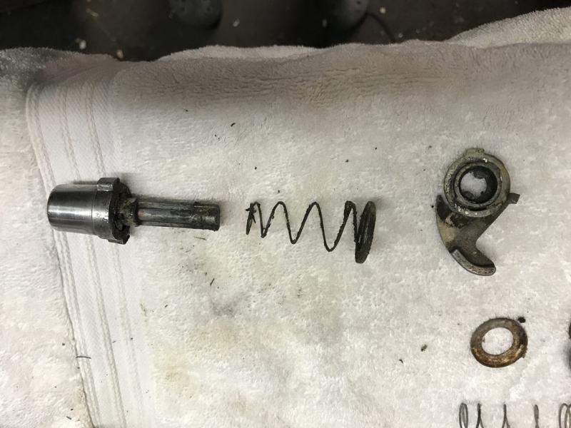

With that out - it comes out and apart to look like this:
Once it is apart you are left with the key barrel and it has 5 brass "slots" which align when the key is in the barrel. When the key comes out - they are spring loaded and "pop" out into a channel, preventing the barrel from turning.
This picture shows the barrel with and without the slots. They just pull out with needle nose pliers - from this side. under the slot is a small spring in the round part of the slot - I used a dental pick to get them out.
After that it was just a matter of trial and error to get the slots in the right order so that when the key is in the slot none of the slots sit proud of the barrel keeping it from turning. The way I did this was to put the key in the barrel and push the slots in from the outside - if the end "disappeared" into the slot, it would probably fit - and it did. and the slots just push back in with a bit of presuure from my needle nose pliers.
This pic sort of shows how I did it.
