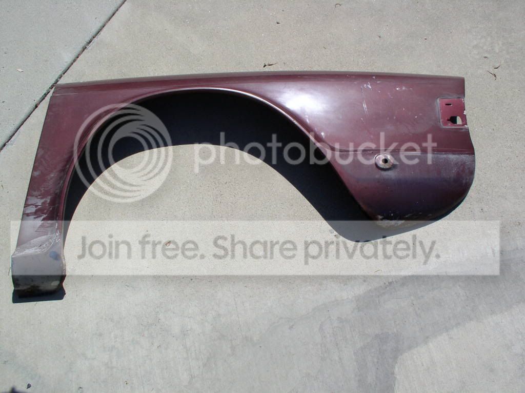

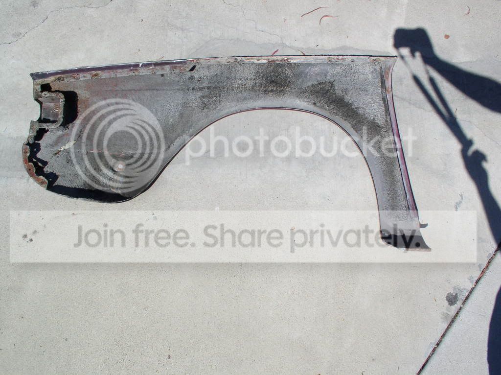

Managed make some more progress today on the rear fenders.
I took both rear fenders over to be dipped. They actually look fairly solid, but I'm sure there will be repairs needed;

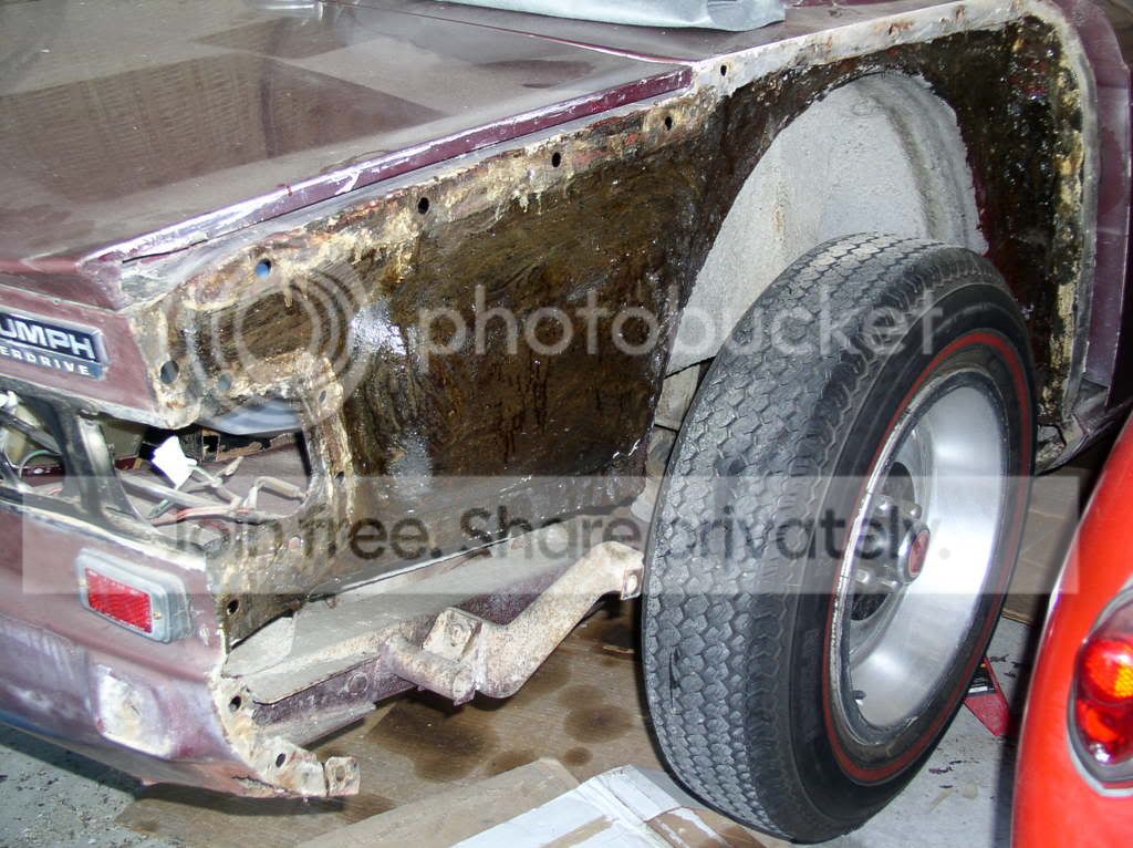

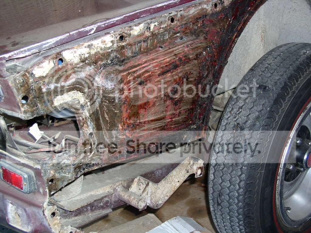

Then I started in on the undercoating removal. I put on several thick layers of Jasco.
As it was;
First coat of Jasco
And then broke out the heat gun, which would have been a better approach to start with as it turns out.
So far it looks like the pillar and sill are in OK shape. The remaining stuff there is dirty, but not rusty.

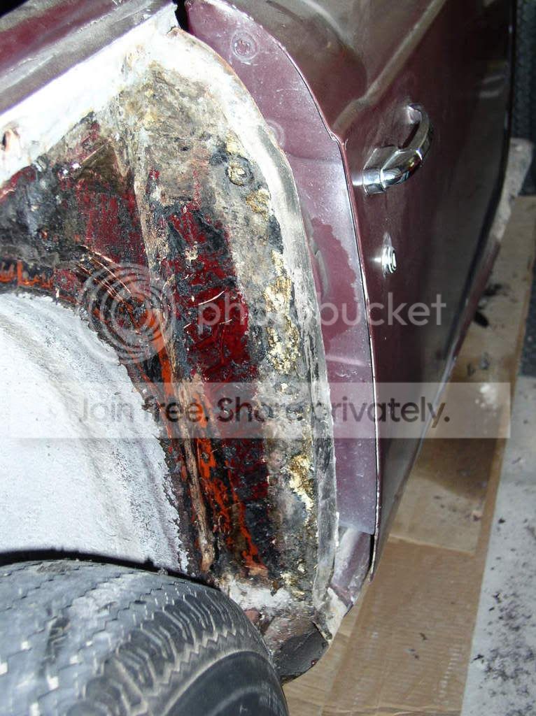

As to what you'll find here is what my other b-post looked like after a lot of clean up;

I don't understand why that spot behind the doors on the TR6 is also a common rust area. It was 24 years ago when I removed the rear fenders on a TR6 that I had so I don't recall. Is there some sort of rubberized gasket material between the fender and the B post that holds moisture? You would think the water would drain out of there pretty easily.

At least on my car, the rear fender plate does not fit snug to the B post at the top. This leaves a 1/8-3/16 inch pocket for water to collect. The undercoating that was applied did not seal it completely, I had rust holes to fix.
