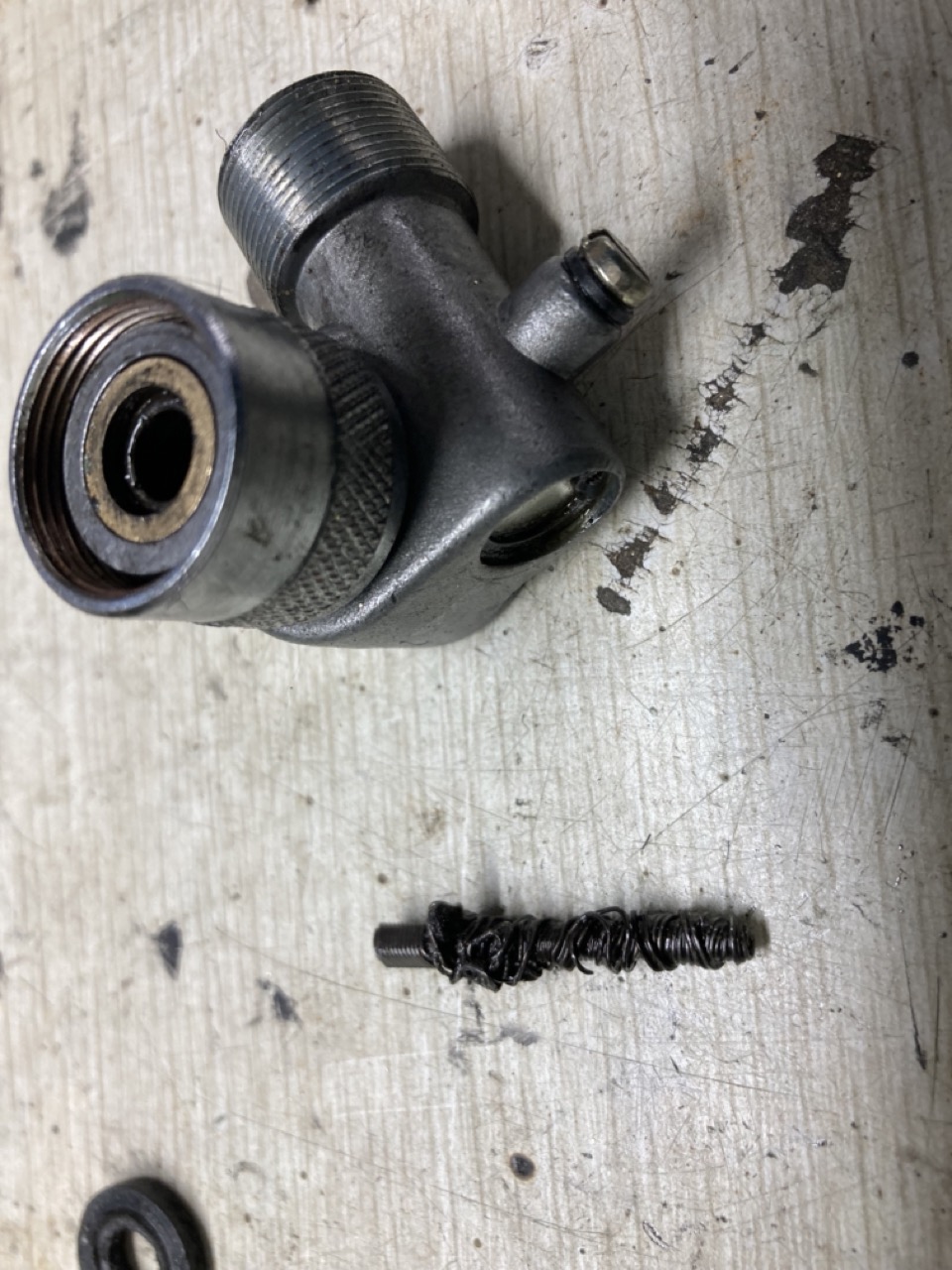

I am rebooting an old thread since it's a related issue. I've owned my BT7 for 60 years and have had to replace the angle drive several times. Always the same issue. The short cable that goes into the transmission gets twisted and fails. I've repaired a few and purchased a few replacements.
400 miles ago I installed a new one and last week it failed. Same problem, twisted short cable. I checked and there is no issue with the speedometer or the long cable. It seems the two small gears in the angle drive bind up in some manner and the small cable suffers the pain.
Anyone have an answer as to why they fail and how to prevent? Would a solid square shaft work better than the short cable? I am getting good at replacing them. Oh and yes, I have the small washer installed. I did have an old one on hand and it is working well so far.
