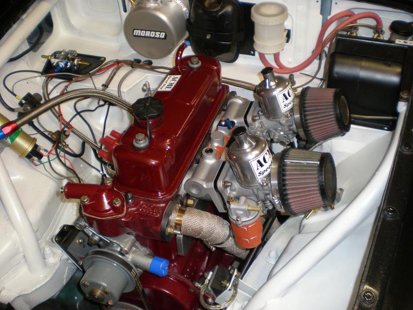

Paul, this Fred McConnell's MGB race engine, I built it, it is painted with Duplicolor dark canyon red, then cleared over with Duplicolor engine hi heat clear, I've done quite a few engines this way, his has held up very well.

OT: white is the best color for an engine compartment, ever (a real plus if the entire car is white, as sponsorship lettering shows up better too).
Is the lifter galley plate all one (1) piece, or two (2)?
