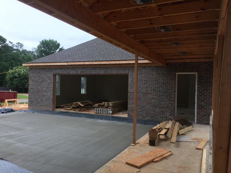

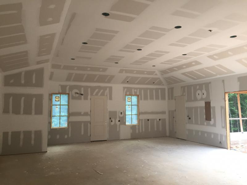

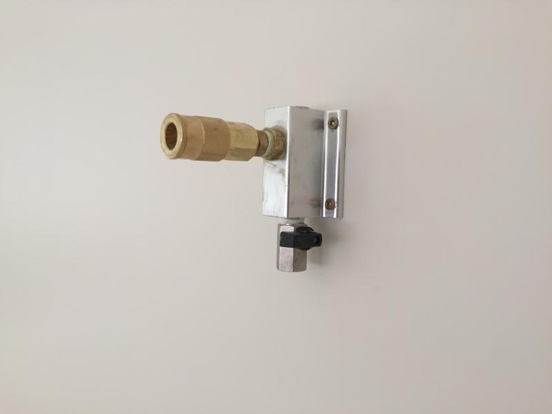

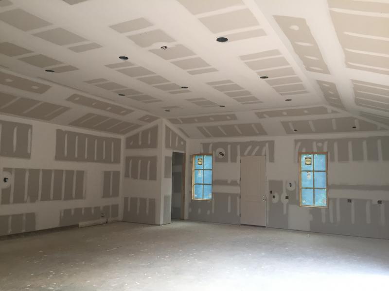

I’m getting closer and closer to having a finished shop and I cant wait to start equipping it! I ran 3/4” RapidAir piping and outlets so I would have the volume I need for those air hungry sand blasters, shot peen cabinets, body sanders, etc. The 2 post lift will go on the left side with room for a car/tool box/mill between it and the wall. IF they stay on schedule it’s looking like the end of July, but we all know how that goes! Even tho it’s my shop, SWMBO will be picking out the paint colors and I’m trying to steer her toward a light grey, but I would like to hear your suggestions. I also let her talk me into using spray foam insulation and a small split system HVAC for comfort...how does that work with the doors open?

I wouldn't drag some greasy old British car in there. WAAAY too nice.

If youi're going to be hanging stuff (rakes; snow shovels.....) off that glorious drywall, consider screw a horizontal 2x4/2x6/2x? properly to the studs, then just putting hooks/whatever onto the horizontal chunk of wood. No searching for studs; no molyscrews; no annoyance when you want to move a mounting and leave holes in the drywall. Jealous! Doug

I had them put 2x8 blocking between the studs for mounting heavy items, peg board, etc. If it’s not car related I’m going to store it in an area under the deck that will have dry space, so I’ll lessen the amount of clutter in the shop.

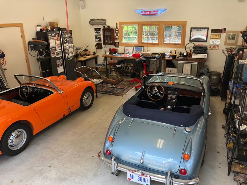

Hi Rut, the shop is looking great. I'm coming to this thread late, but regarding your question about paint color, in my shop I focused on light. There never seems to be enough light to see what you are doing, so I went with a paint color that would reflect light well as opposed to drink it up. I went with Sherwin-Williams Dover White, which has a touch of yellow in it, making for a nice warm glow in the shop. Thought I would share.

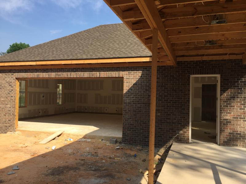

We have paint! We are inching closer and closer and hope to be in by Aug 1st!
