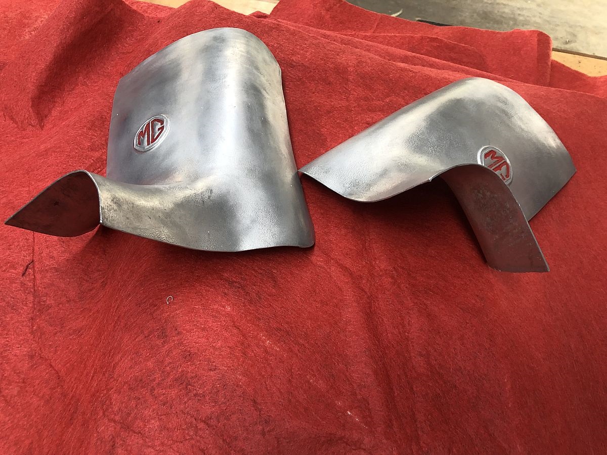

Found these through a friend in Tasmania, 1954/55 MGTF stone guards, and they are on their way to me.
thumbs up
After negotiating with the owner in Australia we finished the deal this morning. They are NOS, have been on the shelf for 67 years, and have never been on a car. Lots of polishing this winter, I want them to look like LaVerne's.
grinning smiley
Made in Melbourne AU by Monaro Motors in the 50s & 60s, they are very rare. I'm very lucky to have a friend who found them for me! PJ

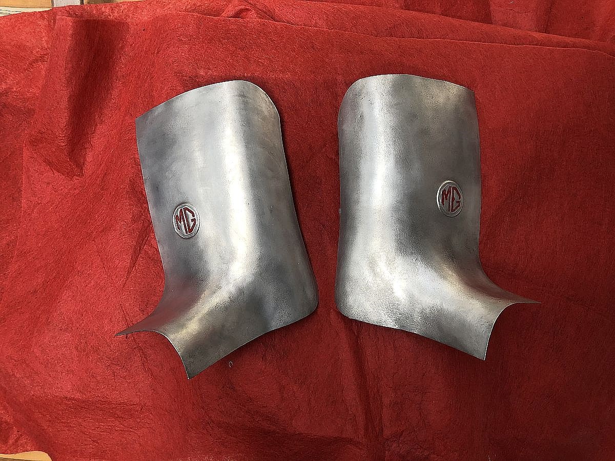

My stone guards came in this morning, now it's polish time. :thumbsup2:
PAUL161
PAUL161

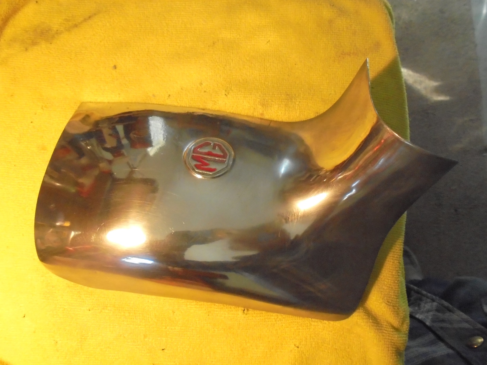

Here's how they came to me, a lot of mold marks from the press forming them which created a lot of hand work. the second pix is where I'm at now, on the left fender guard. Lots more to be done with 600 emery and a lot of buffing. I use jewelers rouge on the first buffing and Mothers polish after by hand. Got a ways to go yet just on this one. PJ

Very nice work, Paul! How do they line up on the fenders and running boards - any tweaking necessary?

The outer edge had a slight gap between it and the fender but massaging it gently by laying it on a thick piece of packing foam and a small rubber hammer along the length curved it back in. The fitment to the running board wasn't quite right, so a fender dolly and hammer fixed that issue. The main thing I found was shelf damage over 65 + years. The left fender will more than likely have the same issues. Being made back in the 50s and 60s old technology and ancient equipment compared to today, they did a pretty good job of making them. I haven't checked yet but have been told that the press for each side was slightly different, so the measurements won't be exactly the same, but not noticeable. Fun project! :thumbsup2:

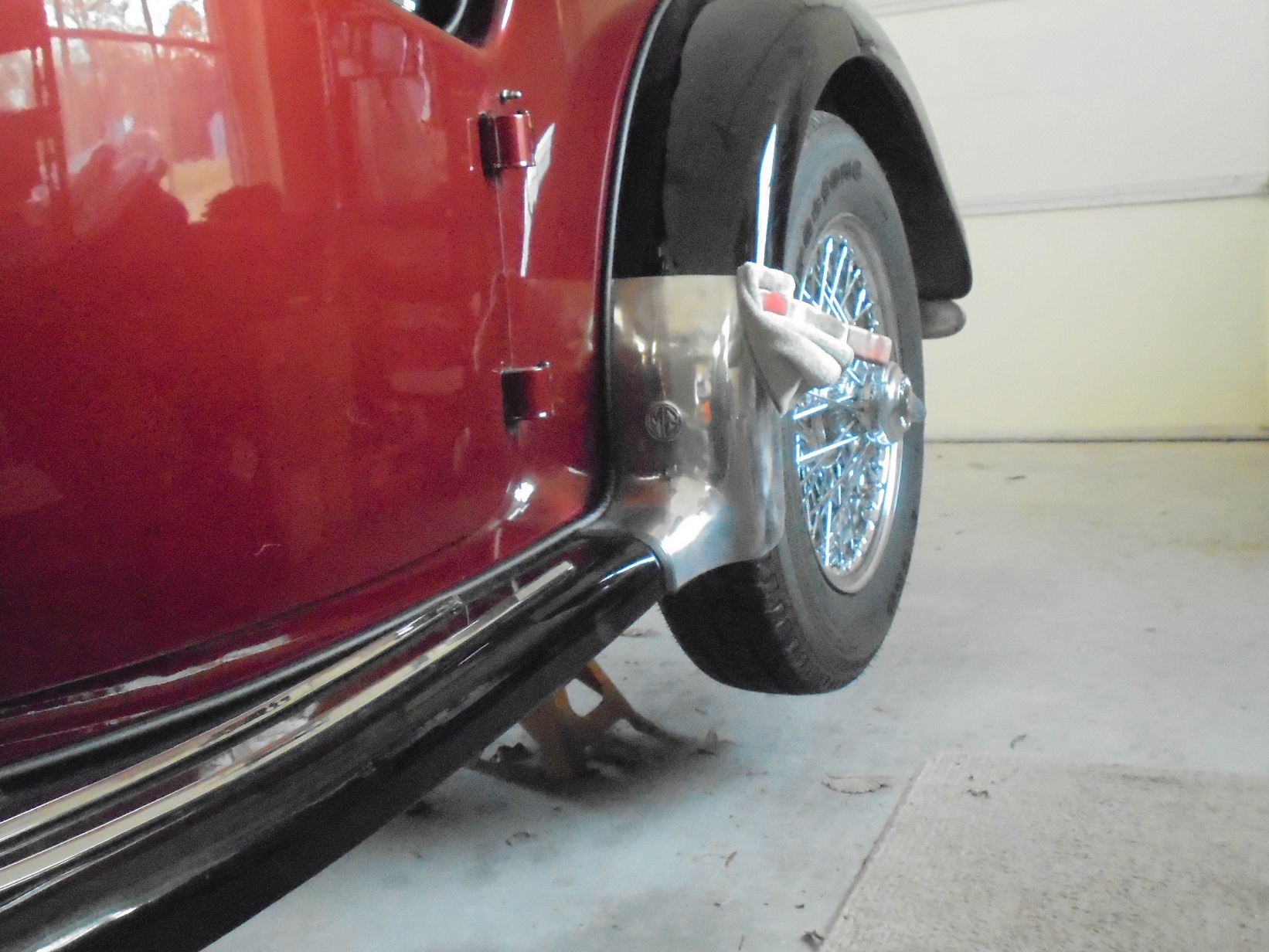

Fitting to the left fender, as they don't fit out of the box, a lot of work has to be done forming them to the fenders. This one is not done yet and needs final polishing but getting there. :rolleyes2:
