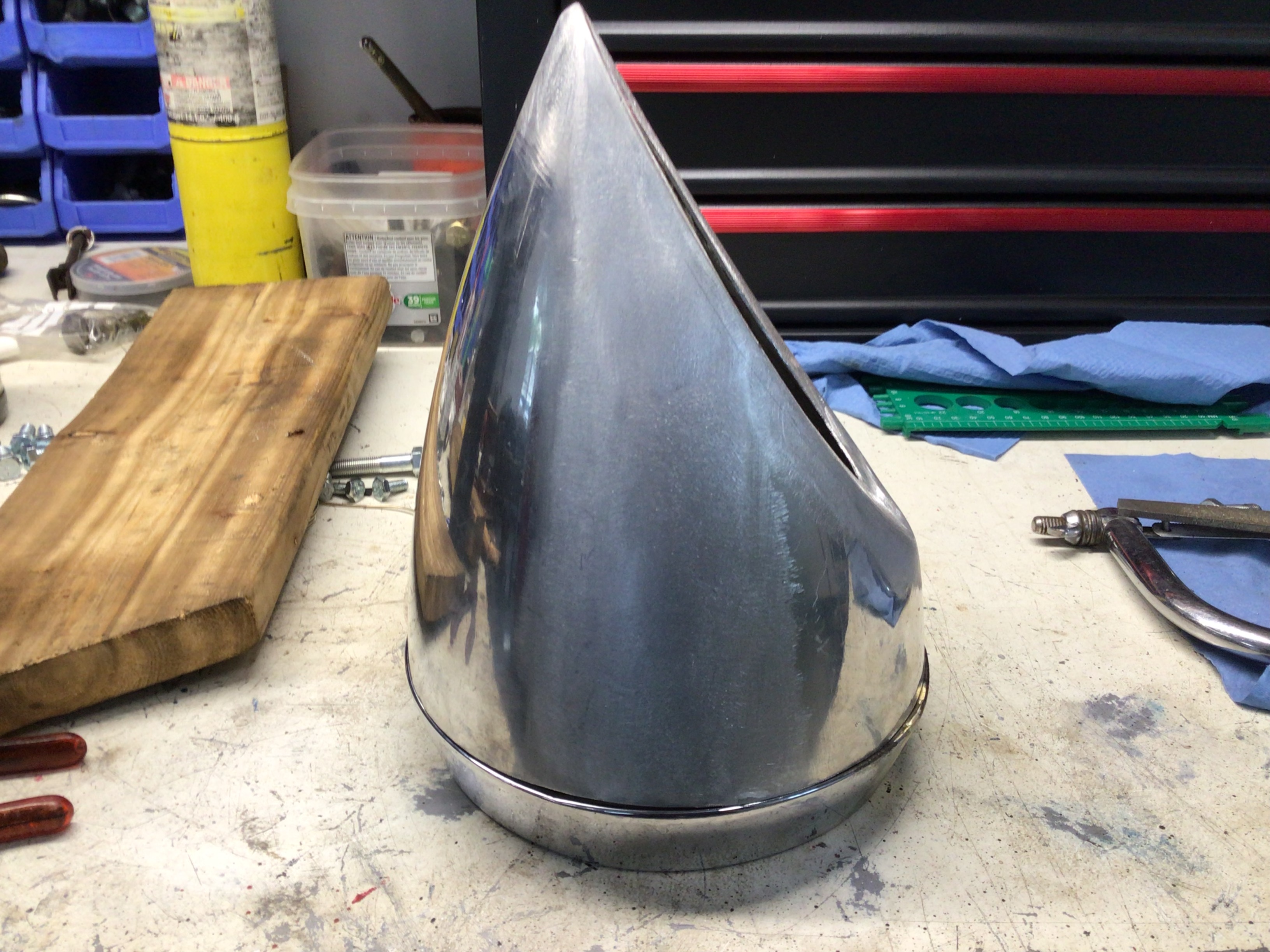

Just for point of reference see attached .
Its a pic of the replica rally pods from Dave Hardwick with a 7” standard Healey headlight bucket and trim ring perched on top .
So that’s my dilemma .
I checked into the low light Morris option but they appear to have inset lights so minimal trim rings , I need to have trim rings like the 7” Healey ones but in 5 3/4” light unit size .
I do have a some old 7” ones so I may take them to my metal guy to practice on to see if he can cut and reduce them by rolling them on the English wheel .

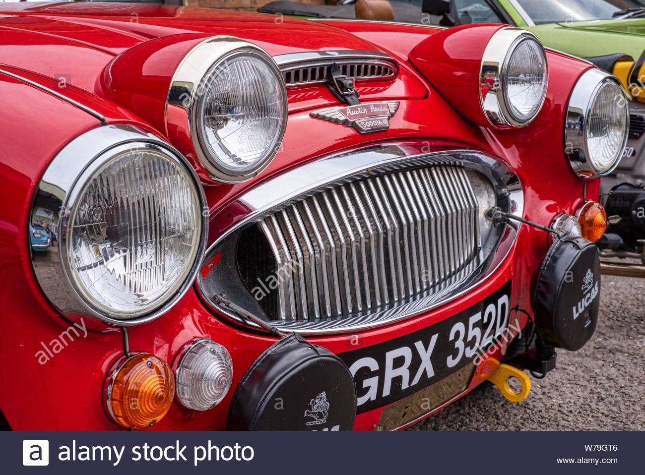

More research has found that the trim rings Im looking for were used on the Austin A90 on the centre headlight as shown in this pic . You can see it’s a pinch ring type . They probably used these on the works rally cars as they were readily available .
I found a supplier in the UK that sells parts for these old girls so fingers crossed he may have a source for me .

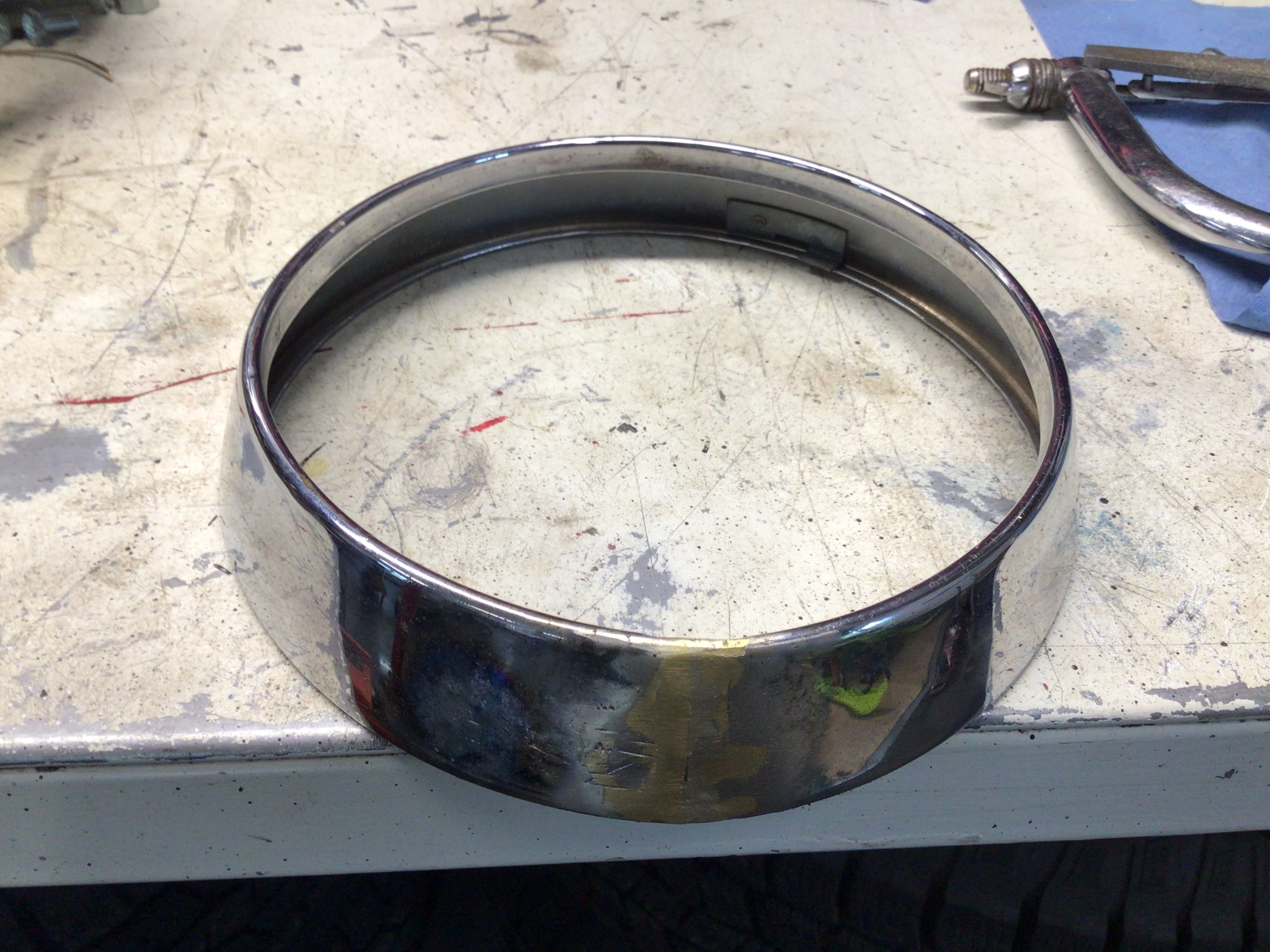

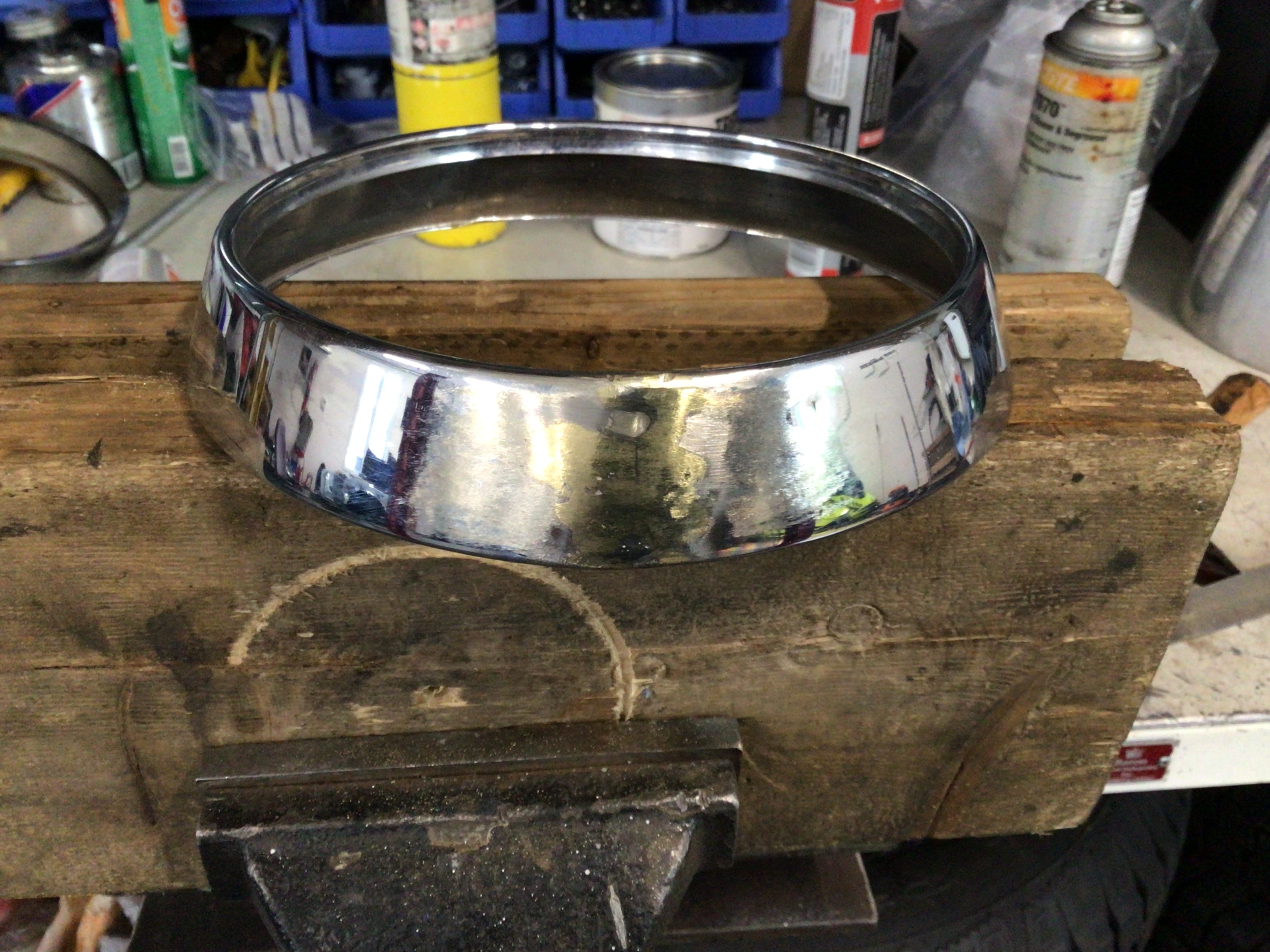

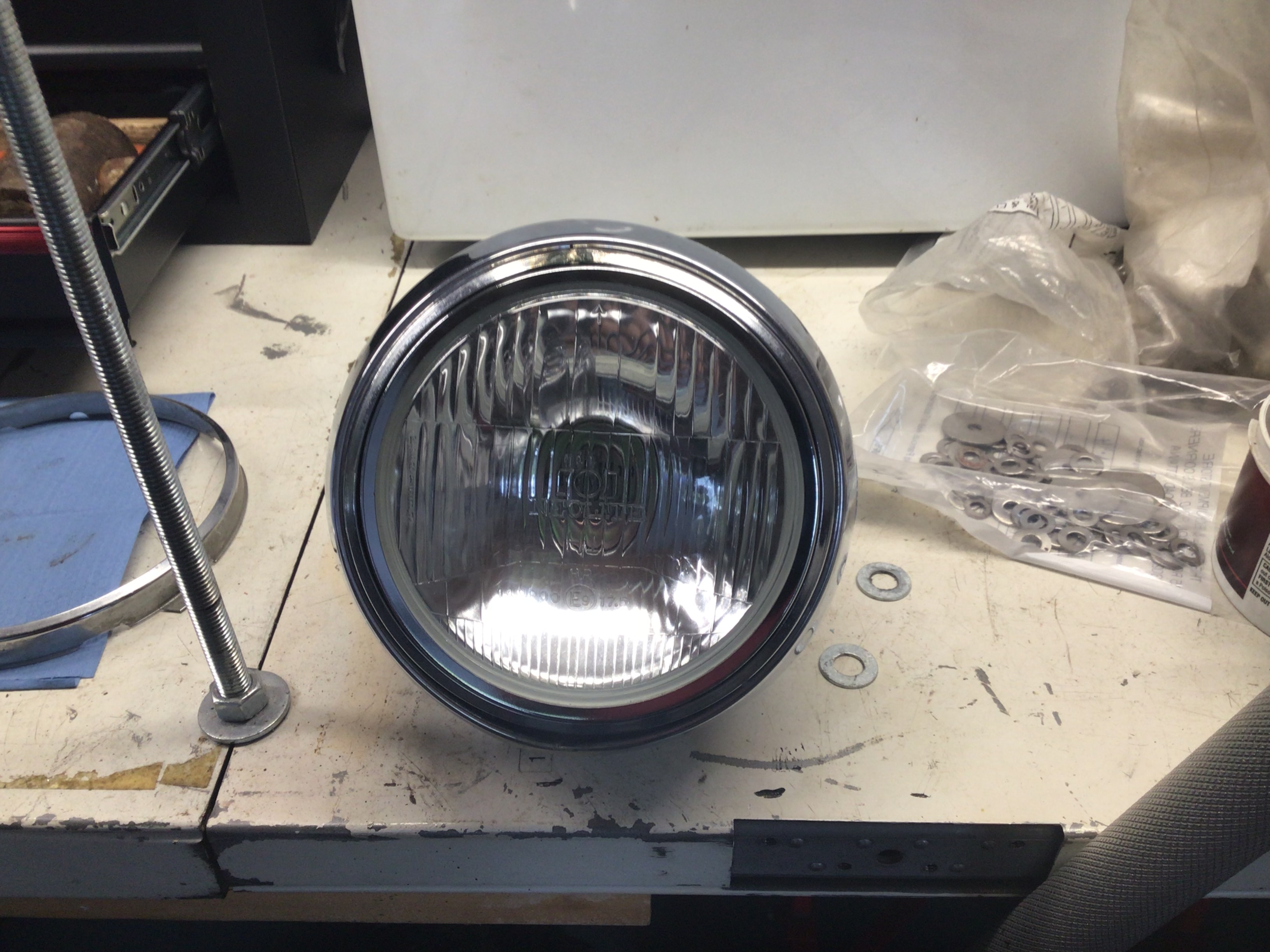

I had no luck getting anything like the originals from the UK . I have some 5 3/4” light buckets etc and some black plastic 5 3/4” trim rings on the way from the UK .
Anyways I decided to have a play with an old 7” Healey trim ring . They are made from thin brass so I cut and reduced it then Re joined it using silver solder .
I impressed myself it’s now a 5 3/4” trim ring .
once the buckets arrive I can assemble it all and see if Im happy with the assembly and results then I can get them rechromed .
It needs a little more fettling and tweaking but for a first attempt I think it’s a good start .

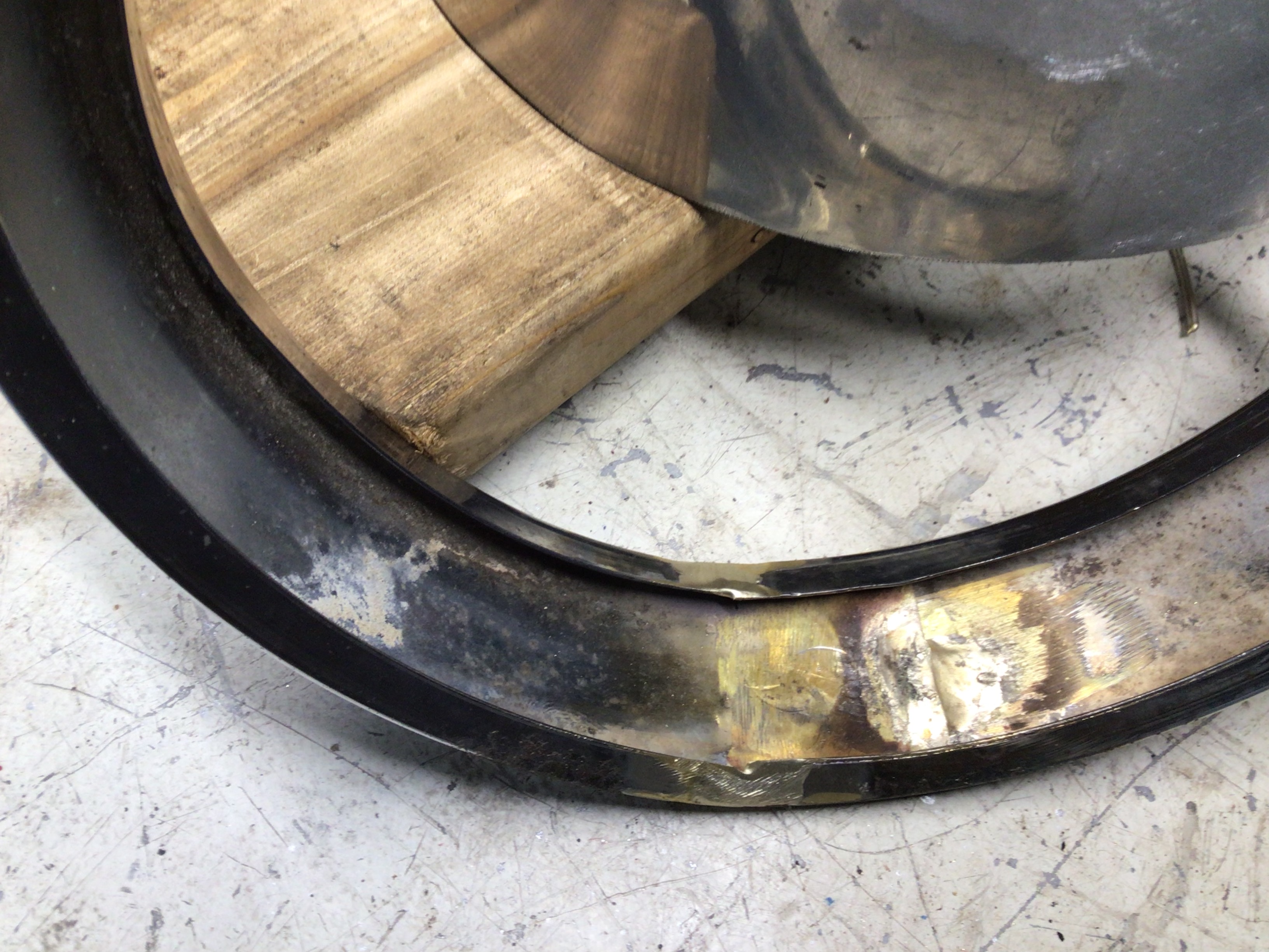

So I tried again and 2 attempt with a reinforcement piece was a dismal failure . So back to the drawing board with number 3 . I spent lots of time preparing the joint and decided to go with a butt joint no reinforcement to keep the amount of brazing and heat/warping down .
I impressed myself , this one is good enough for me if my chrome guy says it can be chromed .
now I need to dig around in the spare parts boxes and see if I have a 4th I can do as well .
If this works out they will for sure be expensive trim rings but I will be happy .

So I finally got all the components for the replica rally lights for my 62 (Other than the rare as hens teeth trim rings) .the actual lamp units arrived from the UK a few days back after being stuck on some big boat stuck in the Suez Canal .
Ive been playing around with the parts and it looks like with some more fettling of my reduced diameter trim rings and possibly an additional reduced diameter lamp retainer ring to act as a filler I will be able to achieve the look I want .
its not going to be plain sailing or cheap but if it gets the end result I want then thats what matters .

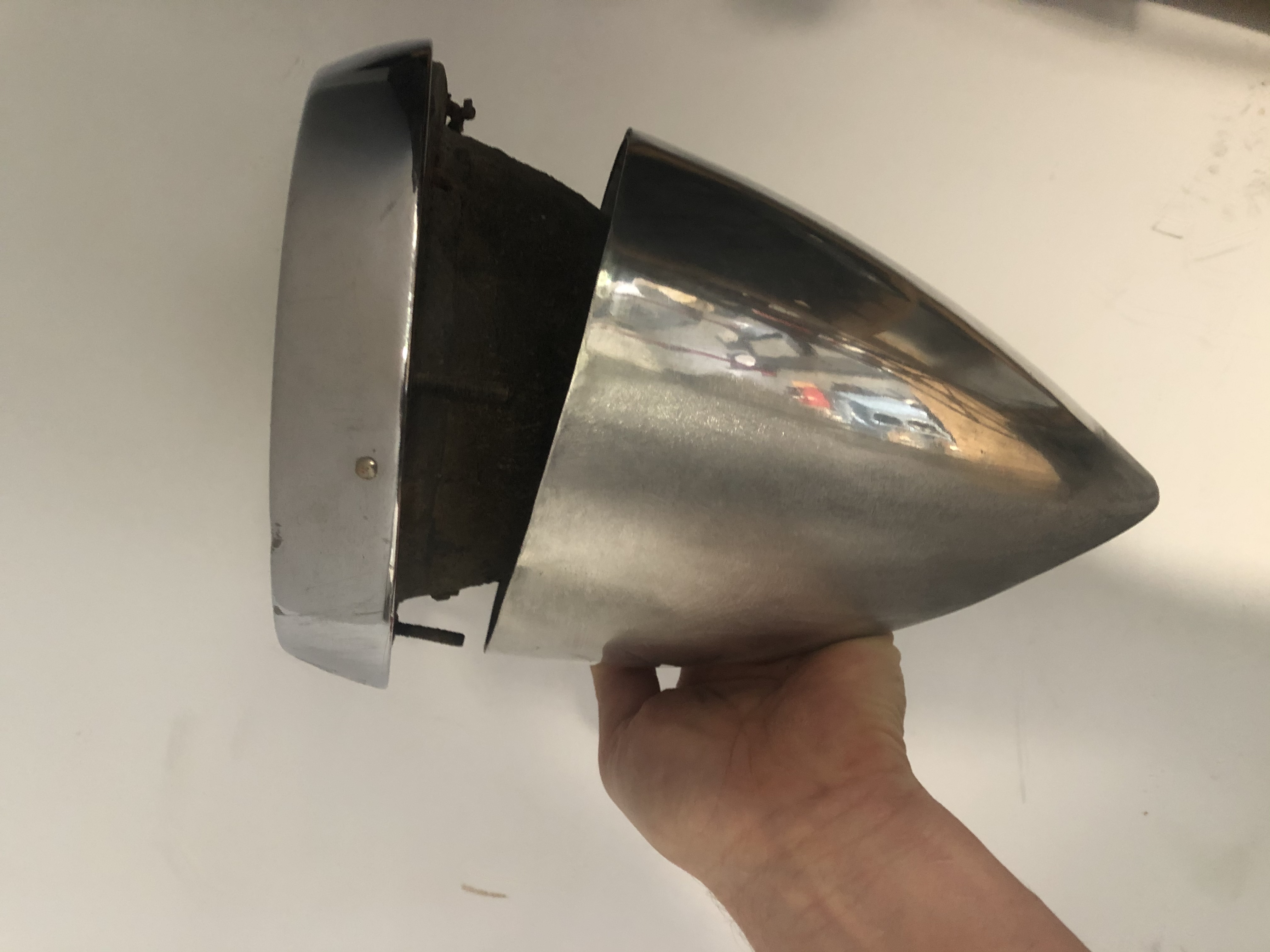

So I decided to have another play with the parts while I’m waiting on some more stuff from AutoFarm to continue with the car build .
I had to reduce the main outer trim ring a bit more , I also used a 7” headlight unit retainer ring which I reduced in diameter to fit around the 5 3/4” headlight . It acts as a filler ring so you can’t see the gap between the headlight and the main trim ring .
some more tweaking to get the shape a bit more exact but I’m generally pleased with the results so far .
What do you think .
