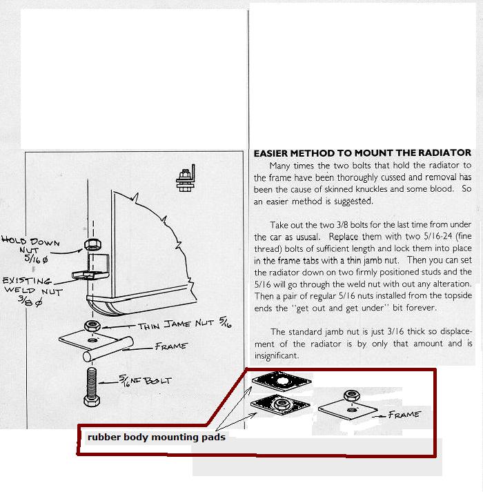

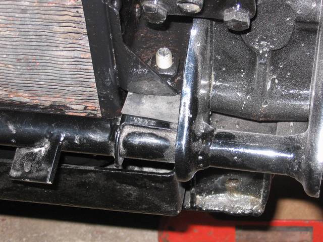

I fought with mine but then used Bob Schaller's suggestion for the remount. I Ground the jam nut down to 1/8", added a couple of rubber body mounting pads; one to surround the jam nut, one for cushioning. (Randall's idea of the springs didn't occur to me) I like Scott W's idea of ss stock.
FRank
