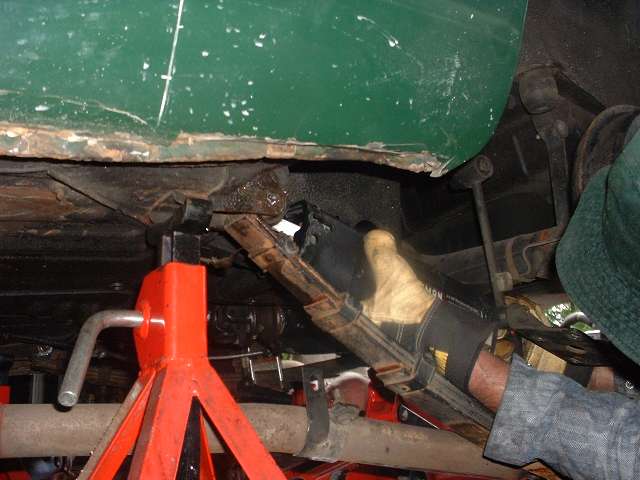

Should be just forward of the front spring attachment. There's some substantial metal there. Maybe someone will chime in with a picture.
Mickey Richaud
Here's a shot:
Mickey Richaud
Oh, and you may want to support the differential housing with your floor jack to keep from tearing the rebound straps.
