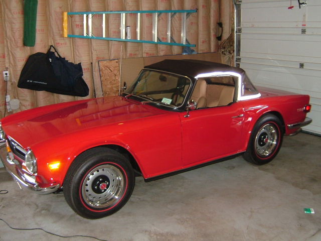

There is a shop near Rochester that does excellent work and it very reasonable. The paint job on my 6 is show quality and minus all the labor to pull the body off the frame, etc, I figured it cost me 5K. It's base clear, with the engine and trunk compartments in enamel. Let me know if you want the info, not sure how far you are from me.
