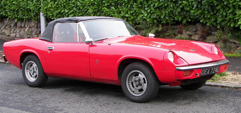

I've acquired a "new" Jensen Healey. First registered Dec., 1972 so its a pretty early one. As far as I can tell it has only 29K miles on it, the bodywork seems in really good condition, though the engine seeps oil from every pore and burns it too- 3 liters in 200 miles! /ubbthreads/images/graemlins/crazyeyes.gif
But its a lot of fun so far. /ubbthreads/images/graemlins/jester.gif
And the electrics have already started playing up.... /ubbthreads/images/graemlins/smile.gif

Nice...Don't see to many of those around!
Who's idea was it to put those seats in?

They're going to go, that'll be my first big improvement. I've sort of found a set of used seats in unknown condition to go and look at later this week and have already priced a pair of leather trimmed ones (/ubbthreads/images/graemlins/shocked.gif) so something more suitable may soon appear....
It stinks of gas/petrol so I'm tracking down a fuel leak of some kind. And I've got a Halogen headlight conversion kit for the 3000 that might get "tested"....
