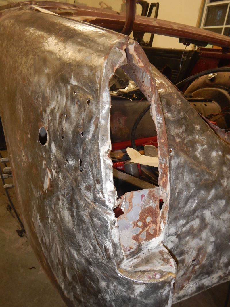

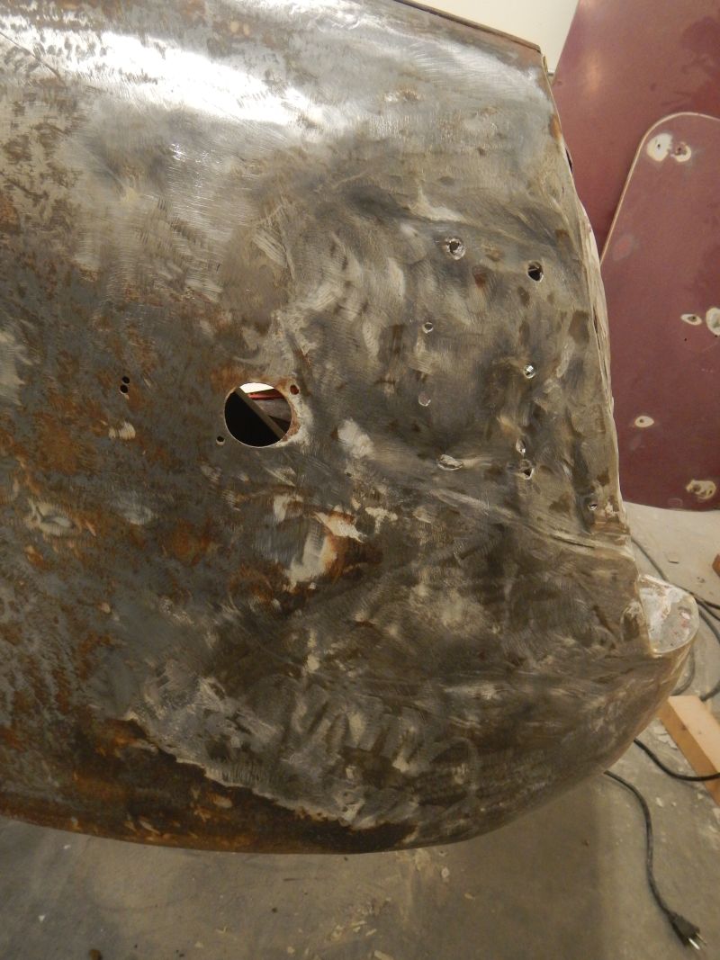

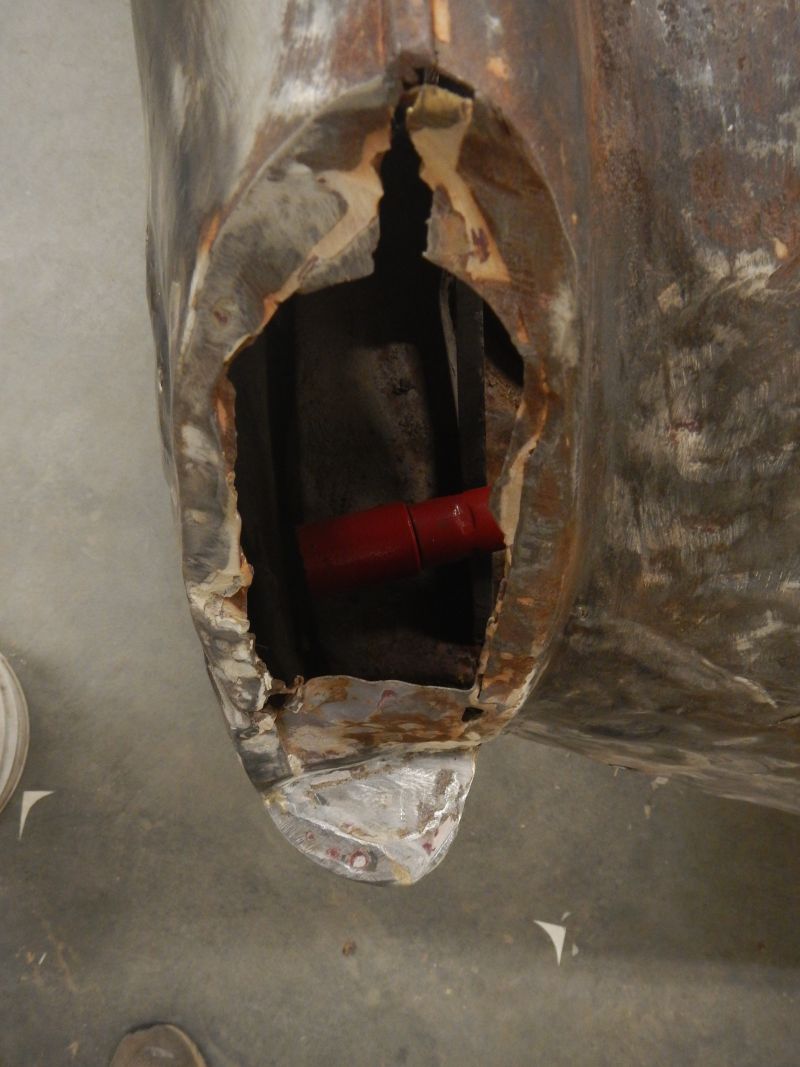

As you may have noticed in earlier photos there was body filler around the drivers side rear quarter. I decided to strip the old filler to see what was going on. I could tell there was accident damage by the lumps on the inside.
With the filler cleaned off I have decided that I need to do a patch high up on the wing behind the side marker as the opening for the rear light is messed up. It will enable me to delete the side marker as well. The rear apron has suffered several incidents. There is filler under the paint so I think a replacement apron is the best course there as the rear light is bent in a bit as well. I did manage to push some of the dents out with my hydraulic power pack. You can see the holes some PO or repair shop made pulling the dents.
Any thoughts on this.

only that it looks like it was repaired with a can opener. :rolleyes2:
The wiring mods were done by the same guy.

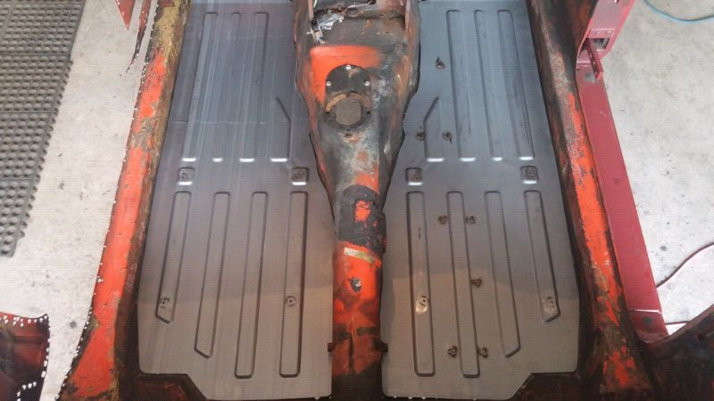

KAS in Australia does the floor replacement panels in front left, front right, back left back and back right sections. Their price is the same as Moss but shipping kills them. They made great seat pan replacements for my TR3A.

These have appeared for sale locally - no idea about the product but, with the favourable exchange rate this could be an easier/ closer solution
Thank you JP. That looks like a winner.
