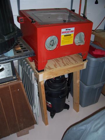

A blast cabnet stand 2x4s around the top with a plywood top and 2x4 legs, all bolted together. The two rear legs have wheels on them so I can easly move it out into the driveway for use. Keeps the dust out of the garage even with a vac on it. Also have a 50 foot line from my compressor so I don't have to drag it out as well.
Room underneath for my shop vac.
Think I will do the same thing for my table saw and free up a bit of space under it as well.

You did bolt the sand blast cabinet to the table, I hope!

No, still thinking on that as it is nice to be able to tip it to get the sand back to the correct end. Was thinking about a back and half sides to keep it in place. Would use a 1x4.
Pythias
Hinge the top at the back and put a latch on the front, THEN bolt it down. Best of both worlds

By golly I bet a bunjee cord would work just fine. Will try in the morning.

I don't see your bong for the Blast Cabinet. One of those 2 Gallon mini shop vacs really works well to suck the dust into the 5 gallon pickle bucket rather than quickly clogging the filter on the shop vac.

I wouldn't trust it....how hard can it be to run some bolts through the blaster's legs & the cabinet?
