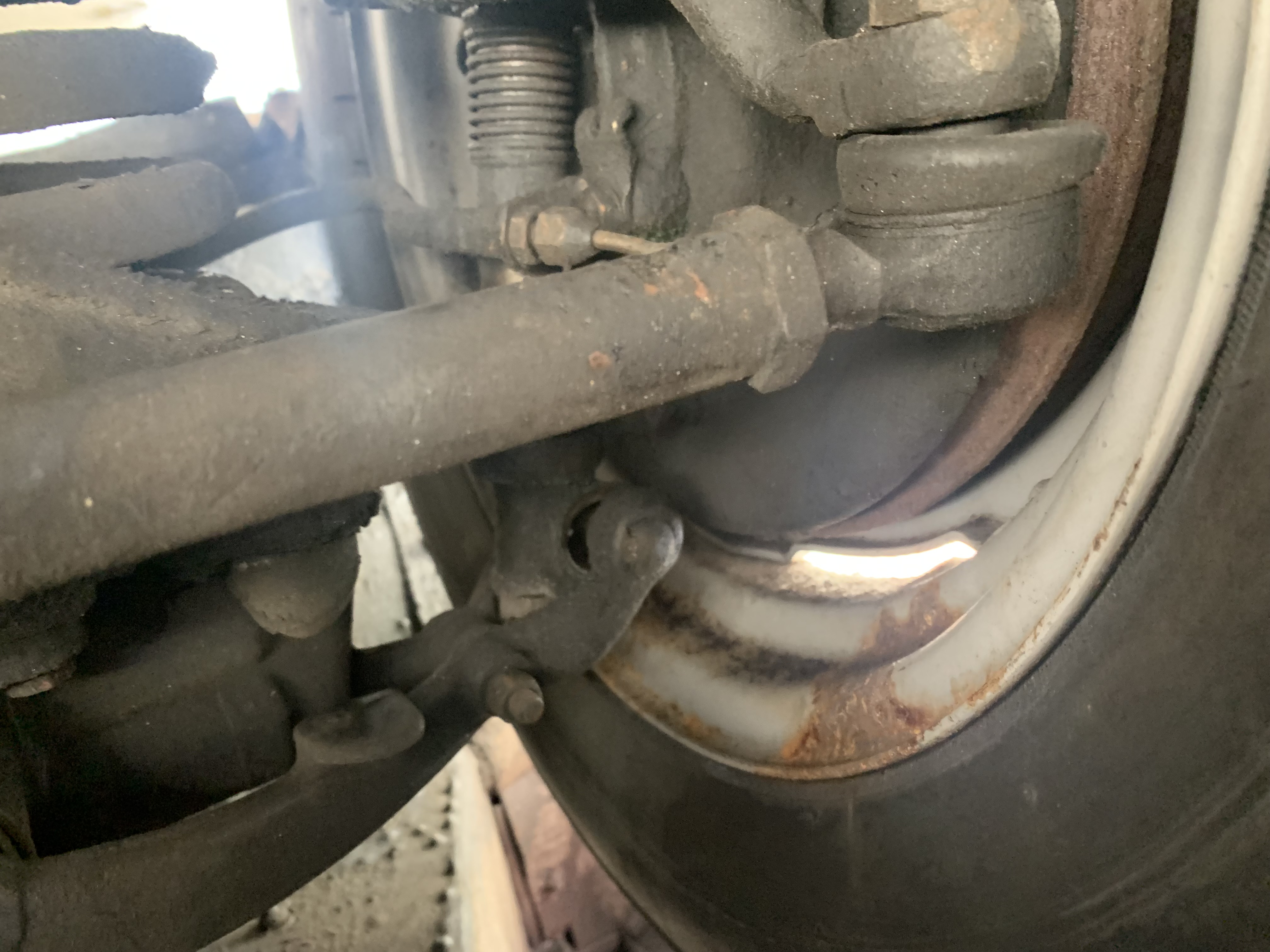

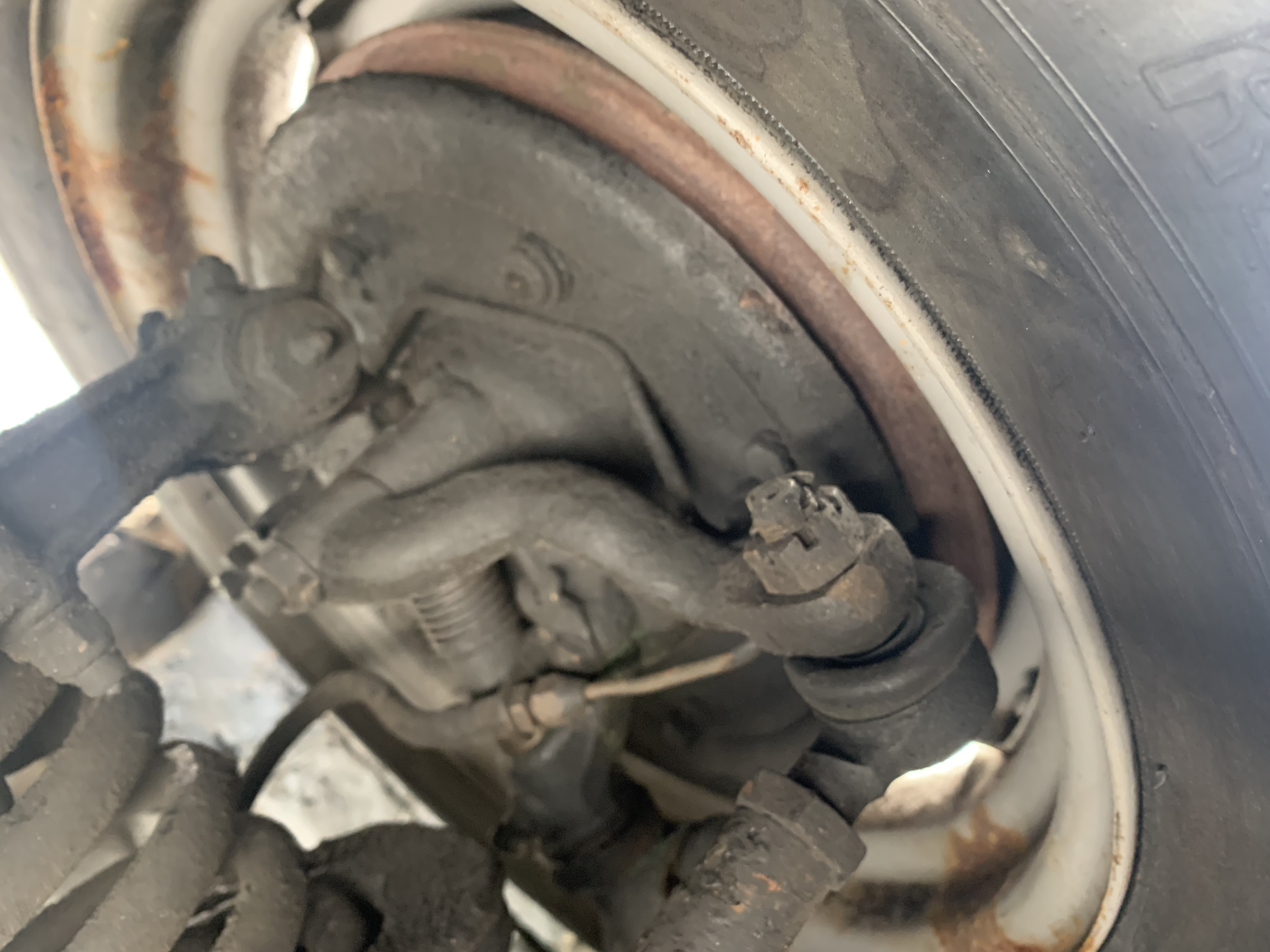

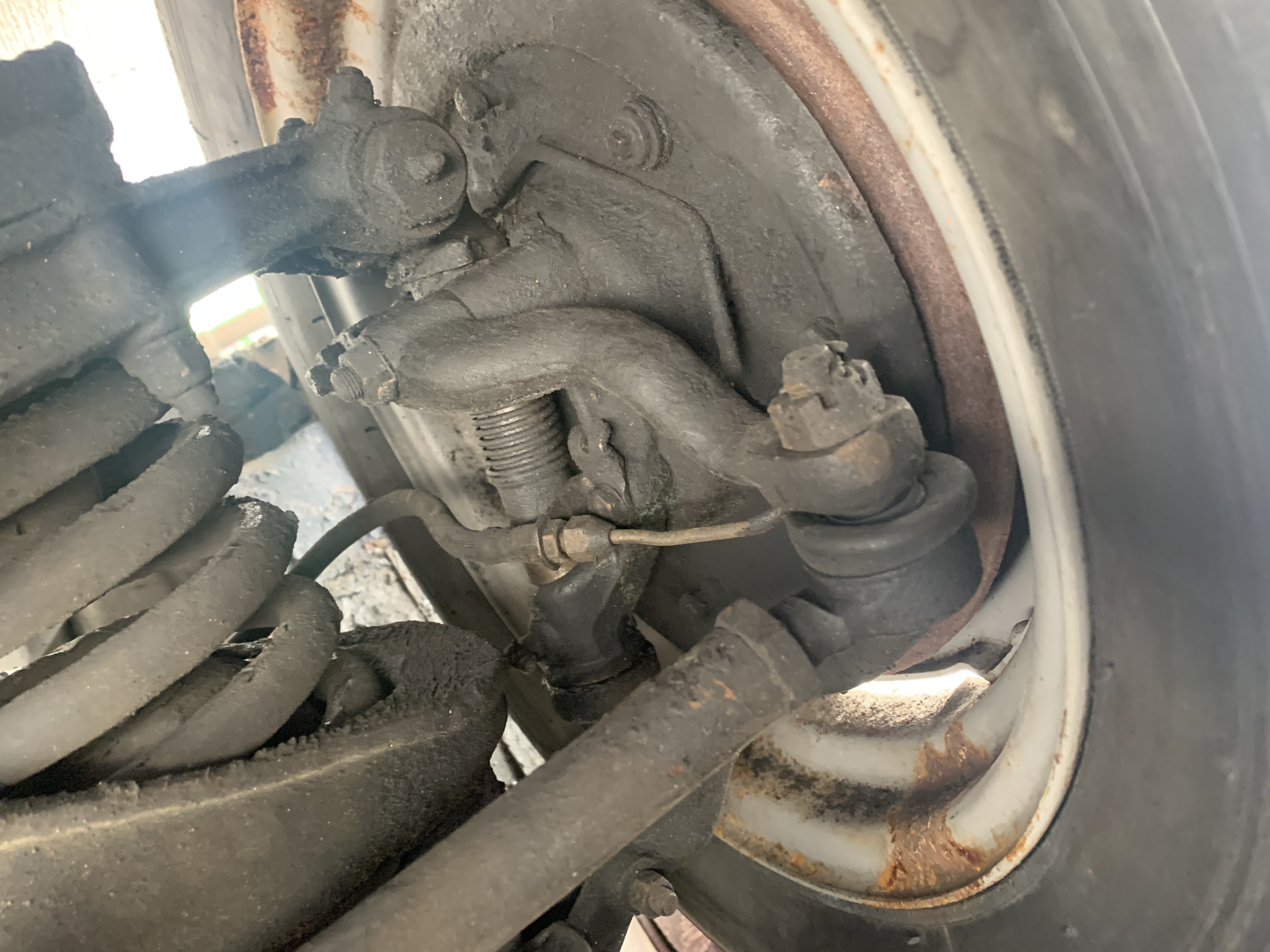

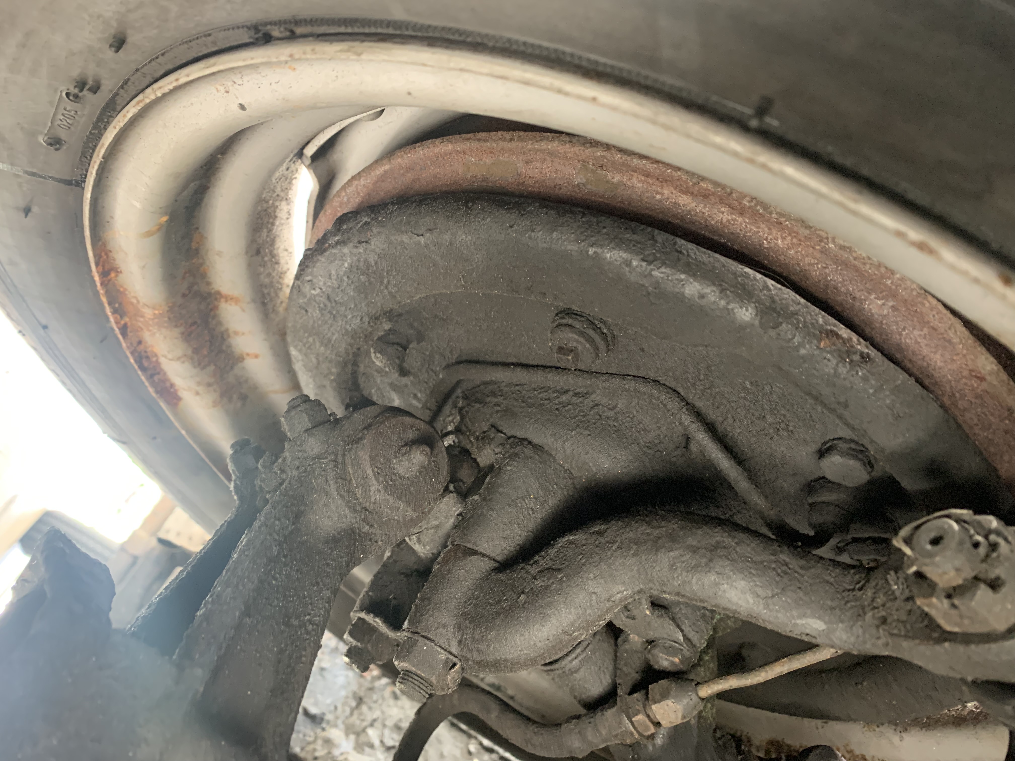

I figured that would be enough information to order parts but the rep at Kip Motors still seems confused as to what parts to send for the suspension. He asked if I had front dis brakes. I took pictures of the wheels and I cannot tell if they are drum or disc as everything is covered. I have attached the pictures. Can anyone here tell me what brakes these are?

Try removing one front wheel.You should easily be able tell then.
M
Mike B
Yeah....so now things get even curious-er. It has the Nissan 2.7 liter engine with front drum brakes. I was told that there was a switch to front disc brakes with the Nissan engine. So now I don't know what I have in the suspension nor does Kip Motors. They said I may have to pull the bad parts, send the parts to them and have them match them up one by one.
PAUL161
From what I see they look like drum brakes to me. ?? PJ
