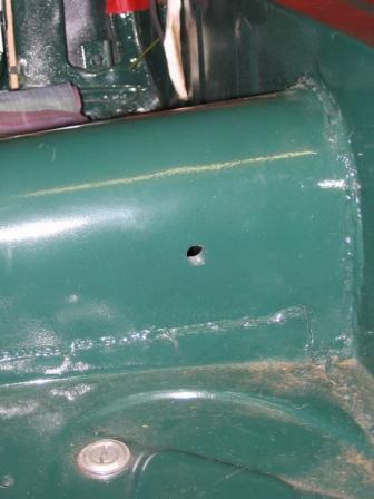

Hey Mike,
Not sure if I'm seeing this right. Aren't the bossed areas where the bolts go supposed to be "indentations". That is, arent they supposed to allow the bolts heads to be below the pan surface where the seat rails attach? Pat
Sorry...think I confused you. The pic is not Mike's. I was just showing him how it should look. It sounds like he's got something else going on.
John
The large bolt in the rear floor should be a flat-head screw as shown. If you use a regular hex head bolt, the high bolt head will prevent the seat from sliding all the way back.
Also, some TR owners cut the carpet away where the seat tracks are secured to the floor and this lowers the seat even more to cause sliding difficulties.
The bolts securing the body to the frame near the "A" posts as well as the "B" posts should be down in depressions in the floor pan stampings.
