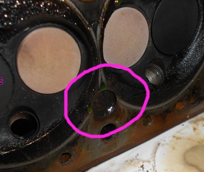

Boink
Bronze
Boink
Bronze
I had the recessed head blanking plug problem. Gave me fits trying to diagnose it (thinking carbs or ignition)... then I got ****** off and pulled the head, and there it was! The blanking plug goes right across the firing rings of the gasket, and the problem is only noticed upon acceleration or high speed.
Rebuilt the head (and they put in a threaded plug).
