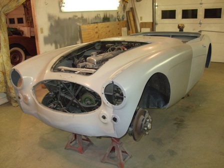

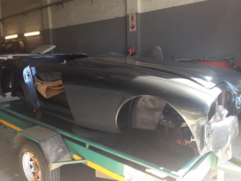

I've bought an Austin Healey 1963 3000 that was in an accident a while back. Car was advertized as full restoration project. The person I bought the car from stripped just about every part he could for another Healey he was restoring. No chassis number. The car I bought was basically the body(on frame), seats, windscreen(broken) and grille. No engine,gearbox, suspension etc.

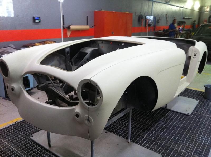

I've had the body panel beaten and spray painted(attached images).
attachment.php
attachment.php
attachment.php

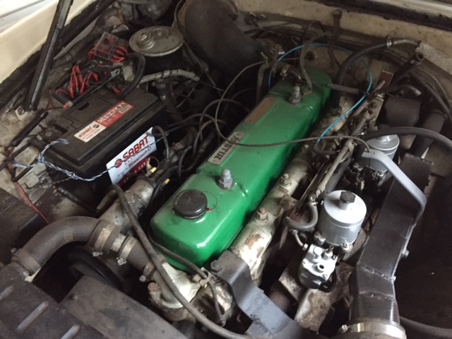

I have been searching for an Engine, gearbox and other parts here in South Africa without any success. I can not find a engine, gearbox or suspension for my Healey. Importing these parts will cost a fortune unfortunately which I can not afford.
Another Healey owner suggested the following and I have no Idea if this would work.
He suggested buying an Austin Westminster A110 and using it's suspension, diff, gearbox and engine for my Healey, since its the same parts.
So my question to anyone would be - Is this true, will this work?

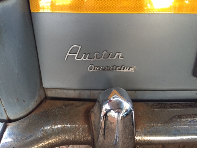

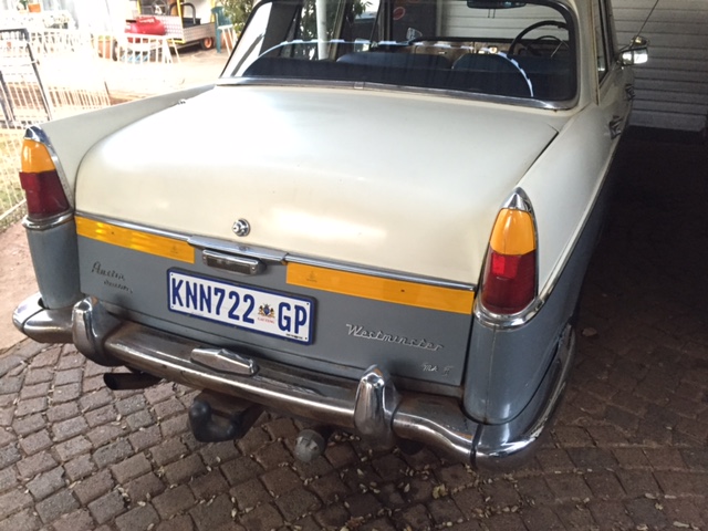

I found a guy selling his 1965 Austin Westminster A110 in perfect running condition and low mileage on the clock(body is rusted and worn). The A110's are also quite scarce cars to find in this condition so I don't want to miss this opportunity.(see images)
attachment.php
attachment.php
attachment.php
attachment.php
If I buy this car, will I be able to use its suspension/chassis, diff, engine and gearbox for my Healey?

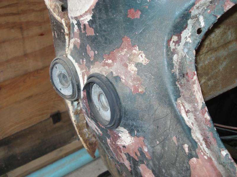

vette
Lleroy, you are in what some might consider an enviable situation. Many of us don't want to modify our Healeys too much because we started out with such complete cars. In your case, you can do so many options. If it were me I would put a small block Ford engine in it with a Tremec 5-speed and a Ford 9" rear. What a long distance tourer you would have then. Maybe Healey Rick will chime in here with his Modified BJ7. Dave.

Lleroy,
I am almost positive the motor and gearbox from the Westminster will fit, but don't know about other parts. Nevertheless, Westminsters are rarer in the States than Healeys so I wouldn't go ahead on my opinion. Perhaps more were imported to Canada and some of our Canadian members may have a better opinion. Better yet, you might try posting on the UK Healey forum, they are probably more knowledgeable on interchangeability. https://healey.hyperboards.com/
I have no clue what modifications the authorities allow in So. Africa or whether you want to modify your car with an alternative driveline. It's certainly more work than replacing with parts meant to go into the car originally, but can also end up in a superior performing car. You can see my car here: https://forum.britishv8.org/read.php?13,8264 Here, Ford and Chevrolet V8s are the common choice, but I've seen BMW and Nissan sixes used and some talk of a Lexus V8. If you wish to go down that road, PM an I can give you some advice.
BTW, that's a very handsome color combination on your car.
Well Lleroy:
Something you may want to consider in spite of the excellent body work.
if you now go to install an engine,gearbox,suspension you may find that the body panels will no longer fit perfectly. The amount of misalignment you may encounter I simply do not know hopefully not too much

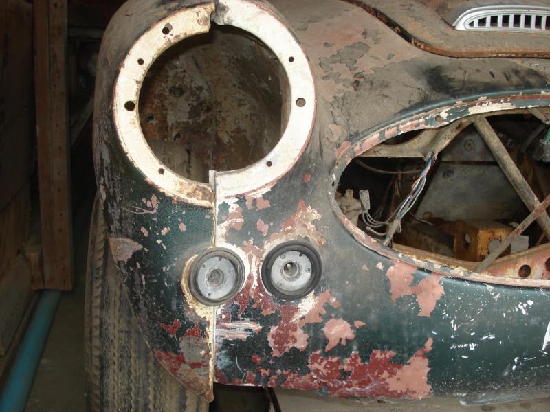

I'm pretty sure with two light holes in front it's not a 1963. anyone?
Nope that is Phase 11 BJ8--Good upgrade-???

The Austin A110 also had the 3 litre engines as opposed to the earlier 2.6 litre. It might be the way to go, otherwise you will be very much going down the custom 'resto mod' route.
healeyblue
Yes that is true, my heritage cert. says German spec also. It should have also came without winged knock offs but the octagon knock offs instead. Mine also has a steering column lock. double rear lights also (small size not large BJ8 style.)

Lleroy, I don't want to sound critical here at all. This is just for conversation sake. Number one, I think your Healey is beautiful. And from the pictures it looks like good workmanship. I agree with Keoke that there is a risk of doing the body without the mechanicals installed. We don't really know how the frame may flex after being weighted with the engine, trans, etc and then being put on it's wheels. But having said that, I don't believe it will be much. I left my engine, trans, etc in place while I did the body and when it was all done and I put it back on it's wheels, the top of the door gaps closed up just a smidgen that could not even be measured in Fractions of an inch. But it did move some. The engine and trans will help to hold the front 2/3rds of the car. But it is the back that is hard to replicate it's loading.
Even though there is significant structural changes to be made to Modify a Healey, It is my opinion that all of it can be done without messing up that beautiful body that you have already completed. Any good LIVE AXEL rear end with the proper width can be put in quite easily. Now I must say that I don't know the car building culture in South Africa, but in the US there are shops in every town almost that are capable of the work. The engine and trans configurations have already been work out by the Modified Healey crowd. That leaves the Front Suspension. If you look at all the custom PRO TOURING, PRO STREET & HOT ROD BUILDS going on, I think you will find that any kind of suspension can be bolted into the front of the Healey with some routine welding for bracketry. And I believe it can all be done without disturbing that beautiful paint job. As example, check out the 'HOT ROD GARAGE" on Youtube to see what has been built into any car. "Detroit Speed" and others have suspension systems, etc. with A-Arms, Shock mounts, & Coil Over springs and more that are just about bolt in systems. I just wanted to speak about the possibilities. Enjoy, Dave.

The diff is the same as the healey diff's from after the spiral bevel axle of the earlier 100's. The axle should be very similar, if not the same as most Healey's. But it won't have the brkts for the later BJ8 bars which came with the phase II Bj8's.
