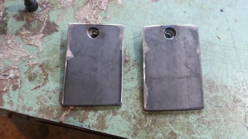

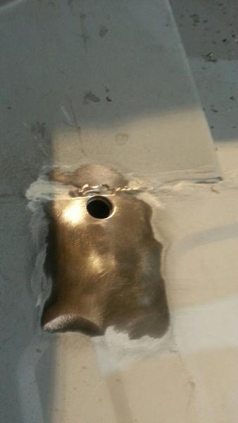

I ran into some issues. My original plan was to just bolt them through but where I need to mount the rears was right over the fram rail. I did not want to open them up from the bottom and wanted a bit more rigidity so I took some 1/8 plate 2" by 3" and welded nuts to the plate and the plates to the floor. Makes it easier since I do not need to get under the car to remove the seats.
Once I figured that out I welded the plates in, then realized that I had to use allen key bolts to fit inside the frame rails. Not realizing that they were grade 8 and the nuts i used were grade 5 hard wear... they quickly stripped, I had to cut the plates out, cut the bolts off and re weld grade 8 nuts and install the plates all over.
Then I realized the rails were 1 click off so they were tweaked... had to then move the 2 front plates. I also had to notch out the angled floor that goes above the springs to make room for the slider on that side.
My 1 day job turned into a month with running out of Mig gas and wire... Murphy's Law!
