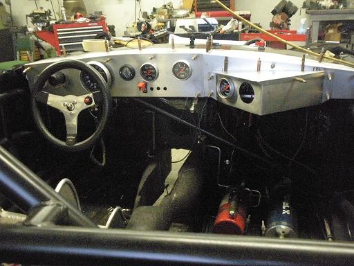

Looks a lot easier than replacing with a fiberglass dash and substantially cheaper. I've got a new prototype fiberglass dash in the back of my garage that has been sitting there for past 5+ years. Never had the courage nor a MOWOG available to unbolt the old dash and chase the grounding issues a fiberglass dash presents. Geat job.
Here's the new dash I made for the MGB race car.

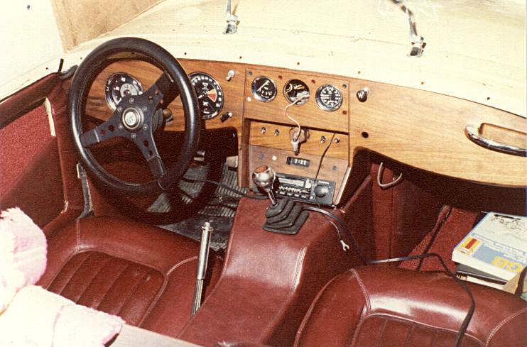

Here's one I made from solid black walnut back in the 70's for my Bugeye. This was taken as I was dismantling the car for a second round of restoration, so things are a little disheveled. Even the light switch know was reproduced from solid walnut.

Wow, Gerard!! Are you sure thats a picture of a bugeye interior!!
Kurt.
Interesting transmission tunnel treatment. Custom or something available way back when?

Quite sure...

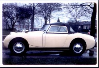

Here's my original (same) car circa 1969
All hand made by yours truly. The seats are obviously later seat foams, covered in leather, Everything was professionally upholstered, including a headliner for the hardtop. The seats are waiting to go into my current Bugeye project. I still have the dash and the console, but not sure if I'll continue to use them in this car.
