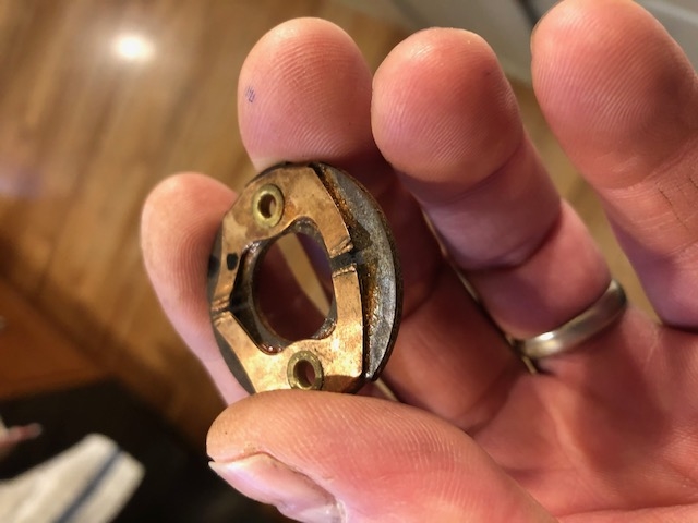

Well, today I’m tearing apart the control head for my TR3A and after cleaning out dead stink bug carcasses and a bunch of dust and grime, I’m ready to reassemble. I noticed the contacts on the phenolic horn contact plate look pretty rough and pitted. Is this normal?

The contact plate should be brass, as phenolic is non-conductive. No, pitting on the brass is not normal, but with a good cleaning with scotchbrite it should work fine.

Yup, the contacts are either brass or phos-bronze. I'll clean them up and reuse.

Of course, they will get pitted again since there's a little high-current zap every time you hit the horn. I got tired of mine not working every time I needed it and added a relay.

Yup Snowkilts, I'm adding a 30A relay so the horn current load goes through that rather than the horn button. Since the horn button will only be seeing the 150mA coil current, the refurbished horn button should last a long, long time. I'm putting a light contact lubricant on all the contact points to prevent surface oxidation and problems in the future.

You should use contact cleaner and absolutely no oil on any electrical contactor. The oil and dirt is what causes the pitting. Contacts, like the points in the distributor, must be absolutely clean. Regular use will actually keep the contactors clean and long lasting. The worst thing for them is to not use them for months or years, allowing dirt and oil to accumulate. That's what causes the pitting you are seeing. My TR2 trafficator had signs of being the original, 60 years old, and the horn contacts looked perfect. I only changed it because the bakelite was, well, baked.

Hi John,
I agree that dirt, oil and grime are no friend of any switch. The pitting in the horn contact is caused by the high current and voltage arc when the horn button is depressed. You get an arc when the button is pushed and an arc when it is released due to the inductive load of the horn coil. When we're talking 10-20A of current at 12V, any oil or lubricant is useless since it gets blown away. The horn contact is a scrubbing design and I'm guessing that was done on purpose to push aside any dirt that accumulates. That's why these contacts are not plated- any plating would be scrubbed or blown away by the arc and a waste of money in this application.
In my case where I will be converting the horn circuit and having the horn button energize a 150mA relay coil so there will be no or minimal arcing in the horn button since the horn driving current will be going through a dedicated cadmium/tungsten alloy relay contact designed for this abuse. The task at hand for my application then is to prevent any corrosion products from forming on the bare horn contact material since at these low currents, I will not be blowing the oxides (and base metal) away with an arc. Any corrosion that builds will electrically insulate the contact interface and over time result in a non-functional switch. A light film of a specialty contact lubricant that ideally incorporates deoxidizing compounds (not necessarily grease), is usually enough to prevent these oxides. This is especially important in a vehicles that don't get driven and used daily.
Even the dreaded Lucar connectors can benefit from a spritz of electrical contact lubricant. These are tin plated connectors and are subject to fretting corrosion that leads to the joke about Lucar connectors being in the wire harness to let the smoke out. Fretting corrosion in tin plated electrical contacts results from unlubricated contacts subjected to thermally induced microscopic motions in the contact interface that result from current on-off cycling. As the interface moves ever so slightly during a current carrying/heating cycle, a tin oxide builds on the freshly exposed tin. When the current is switched off, the contact interface microscopically moves back and rides up on these oxides. These cyclically build up over time and increase the interface resistance. In low current applications, that eventually results in an open circuit. In higher current applications, as the interface resistance builds, that in turn heats up the interface as the current goes through it. This increasing temperature eventually builds up to the point where the contact material anneals and you lose contact force in the connector system. Without adequate contact force and these insulating oxides, the result is a nasty thermal cycle that means that the contact burns up or the insulation on the wire going to the connector melts. Lubricating the connector interface of these connectors prevents these oxides from building up and prevents or at least delays this nasty cycle.
In the end, each connector or switch needs to be looked at as to how it will be used (environment, voltage/current, duty cycle, etc) and from that determine what type of contact lubricant, if any, will prevent future problems. Connector & switch technology have come a long way since our 1950's era cars were designed. Contact lubricants can be your friend in these old cars top make them more reliable if properly applied - I speak from background of 35 years of experience in the connector and switch industry.

Interesting thoughts. Something else to think about is that all the switches on your center panel...ignition, lights, wipers, instruments...also have no plated contacts. Just brass on brass, and the lights especially draw as much as the horns and are used much more frequently. They work good and last a long time. When I rebuilt my switches there was not a single pit on the contact surfaces.
I completely understand your thought process, but grease and oil have no use anywhere near an intermittent electrical contact. The action of the arcing is all that is required to keep the surface clean and corrosion free. That's also why it is important to exercise all your switches every month. If you have a layer of oil for the arc to work through, you are merely providing fuel to burn off metal. I think you will induce the action you are trying to prevent.
Contact cleaner is a chemical formulated to clean oil, grease and dirt off of intermittent contacts without leaving ANY residue. That's because anything left on a contact surface, combined with arcing, is not a good thing.
