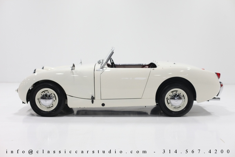

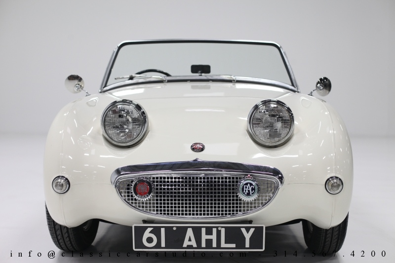

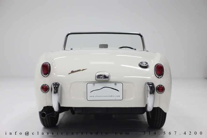

So I found THESE photos (attached) of the perfect white! (at least on my monitor) However, the shop that once housed/sold this car long ago, could only guess at the paint - no color name just a Glasurit formula and he wasn't sure.
This is the formula the guy gave me but it leads to nowhere GLASURIT SA137.20. Ring any bells? Any suggestions on how to cross reference this color? My painter needs a lot of specifics in order to proceed. When I requested an OEW sample using the WT3 code he couldn't find it.
So...shot in the dark, but can you recommend a white that isn't appliance or artic or too bright, is still definitely 60's vintagey, but not so yellow or gray as OEW?

The only advice I have is to find a car with the color you like in person - not a picture. Surrounding colors will influence what you see in the car color, bright sunlight vs cloudy day will also have an effect. For example the pictures you posted show the car in a room with white walls & floor. If you were to see this same car on a paved parking lot or a green lawn the color of the car may seem a bit different... So try to find the color you like 'in the flesh' and if possible in different environments.
I spent many years with a red that I thought I would like based on pictures and the small color chip in a book - but I really didn't like the color once it was on the car. When it came time to repaint, I found a red I liked much better 'in the flesh' and after I painted the car, I still liked it.

IMHO . The bug eye pics you have the white is too white for that car but in person in outdoor light not against a white background it maybe better .
