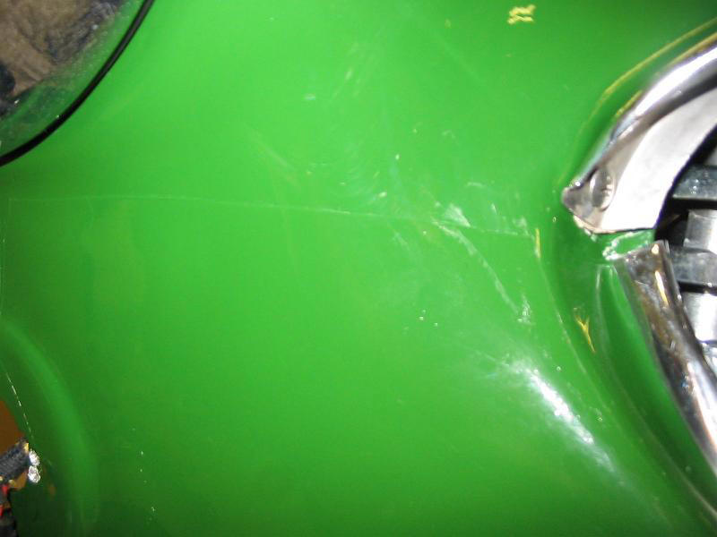

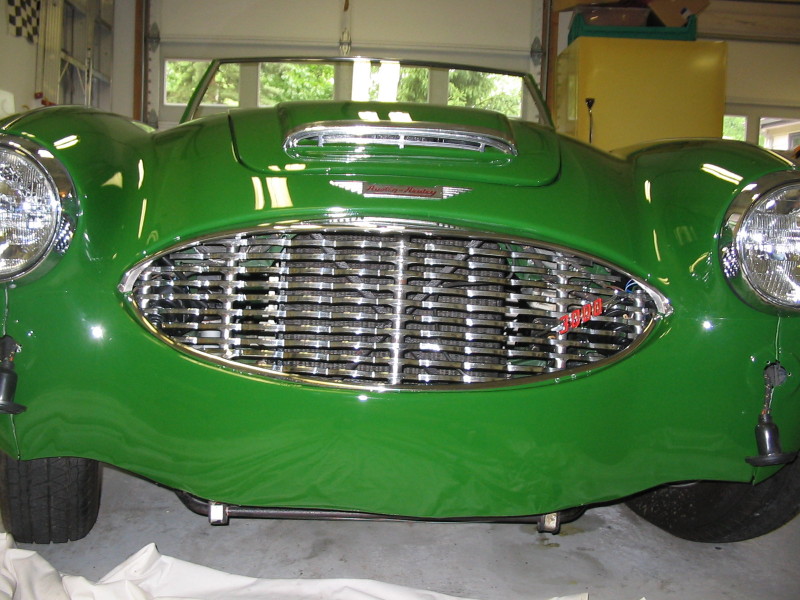

Well, persistence and luck pay off.
Lucky enough to have found the right guy who says he can install the 3m film in one piece!
Persistence trying different ways to stretch the film. We removed and re-applied a new sheet of film till we found the way that worked. 6 times!
Hardest car he has ever done he said. Because of the curves around the headlight. But liked the challenge.
End result is one piece of film. All edges were wrapped. The only edge line that shows is on top. See photo 5 and 6.
1-6 show the process.
1 shows I removed everything for him.
5 shows the line we marked on the film, which he then skored with his blade then removed the excess cut off. The knife blade never touched the paint.
Photo 6 shows the end result. Yes the film is there.
Photo 7 shows how happy my car is with it's new Clear Bra protection!
Cheers, Roger
