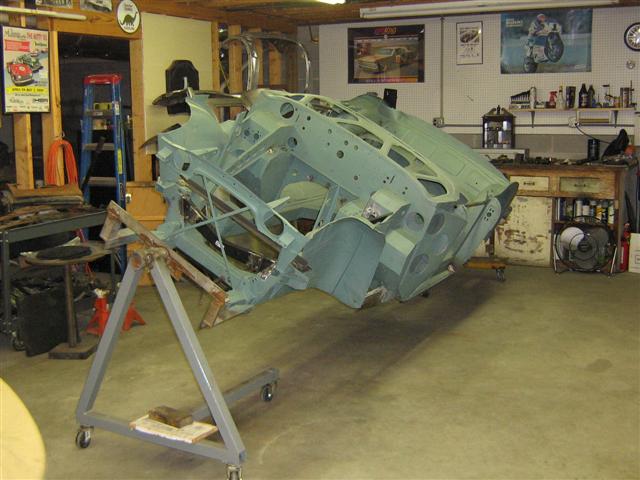

Hi guys,
I stuck my bare '58 BN4 chassis on a set of scales a couple months ago and got 405lbs, this included a 20lb front and rear attachment for the rotisiere. So 365lbs for the chassis. This is a solid original chassis with original floors.
Barry

What does the term 'chassis' generally mean in a Healey given that it doesn't easily separate from the bulkheads? Is the whole body, less bolt-on parts the chassis?
I have seen repro chassis pics that look like just the lower box sections, which I'm sure would be easy to move around. With the bulkheads etc that make up the body of a Healey It'd have to be considerably heavier. Guess I'll find out on Tuesday...
Andy.
Andy,
I'm not sure what the definition of a Healey chassis is, but this is what weighed in at 365.
Barry
