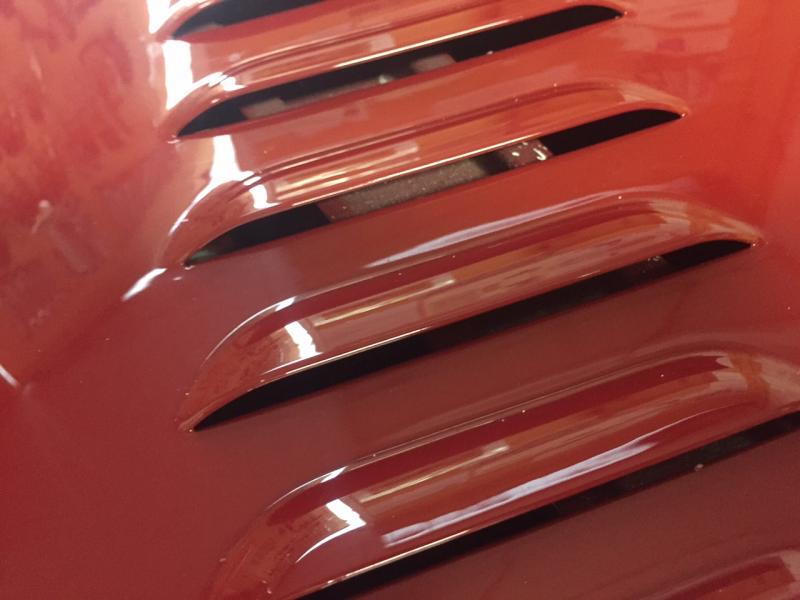

What is the best way to remove dried polishing compound ( probably 3M brand) ? Got it on my louvered bonnet under the louvers which are hard to get to and thought I would ask if someone knows an easy way to do it.

I just used a cotton towel and water and it came off. I am surprised how far it spreads. I still find it in places that are not visible till I put the car up on a lift. That polishing machine can throw it pretty far.

As far as removing dried compound, it needs to be wet to help break it down.
Are you asking because it's hard to dissolve or because the the geometry of the affected area makes it hard to get at?
If the problem is the geometry, a picture would help.
Hey y'all,
Thanks for the suggestions. Here is a picture although hard to tell. Issue is the dried compound under the louvers and in on the reinforcing structure underneath. Think I'll try the lemon juice and tooth brush idea.

If the lemon juice (or other solvent, I usually start with a detailing spray) appears to be softening the residue I'd try something softer than a toothbrush first. Nylon bristles can sometimes scratch soft paint. I always start with a natural bristle brush like a paintbrush, makeup brush or pastry brush.
If you need the stiffer bristles, wet the area well with a high lubricity carwash soap solution or a detailing spray.
Also, a tip I got for removing stubborn residue from crevices from a guy who does concours prep on multi-million dollar classics, bamboo teriyaki skewers.
