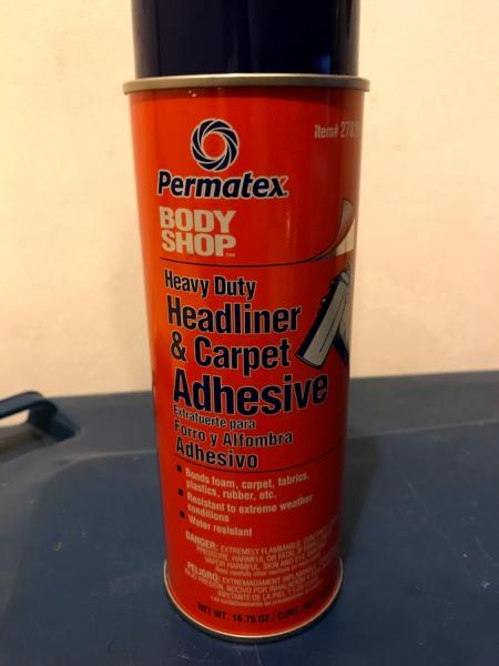

This is what I used. The "web" spray pattern helped with coverage. I sprayed the carpet backing and the car body, let it set for about 5 minutes, and laid the carpet. I took my time on the tunnel and the rear wheel houses to ensure it was lined up before I put the carpet in place. It won't move once the carpet touches the car. I picked mine up at Autozone. Took about 1 1/2 cans to do the entire interior ('74).
