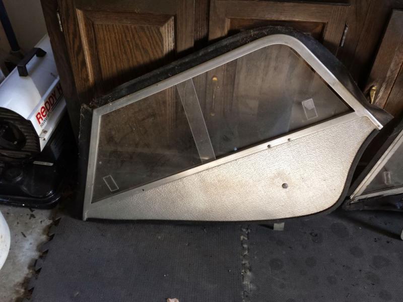

I bought a set of A/M side curtains for my late TR3. I'm don't know exactly what I have. They are aluminum frames with plexiglass sliders. The bottom section, below the window is a solid,pebble grain, panel of aluminum, that fits the drop down contour of the door. I found one photo of a car wearing side curtains just as I described, but many photos of a curtain with the same window frame, but vinyl as the bottom panel. I'm wondering if the bottom of mine should be covered with vinyl, either glued on, or loosely fit over the aluminum. It seems that it would be very easy to cover that panel with glued on vinyl, much like the cockpit trim is done. Can anybody that has the A/M side curtains, tell me if the vinyl is installed over the aluminum panel....and how? Any knowledgeable info would be appreciated. Photos would be a real bonus. I doubt these will be on the car much, but just wanted something to close up the opening for the unlikely event that I get caught out in bad weather. Thanks, Joe

Tom, They are used....very. I went thru the "search" and read what I could find. I did a photo search on google and found a photo of a set that look just exactly like mine, on a car, but only one out of many car photos. It seams that most, if not all, of the a/m curtains had vinyl in the area below the window. What I have read leads me to believe that some were soft "flaps" and some where ridged without any lift the dots needed or used. The aluminum panel at the bottom appears to be manufactured, not home made, as in a repair. Also, the fact that I did find a photo of a pair just like mine, actually on a car, validates they are manufactured...unless I was just lucky enough to end up with the exact set from the photo. My window frames look pretty much just like your photo,even down to the square "handle" on the plexiglass. But, the bottom panel is solid sheet aluminum with a pebble grain on the outside surface. The inside surface appears to have had something glued to it. I think these could be easily restored, if I knew where I was headed. Again, I'm not overly concerned that they be exact as I won't be entering any concourse judging but just want something presentable and accurate for the period.

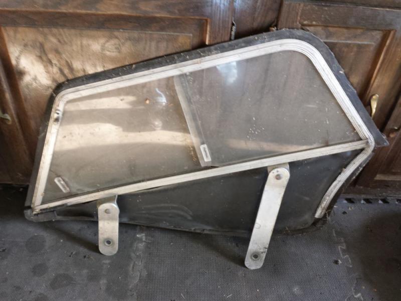

This may be what you have. The part below the window is made from a pebble surfaced aluminum sheet with a rubber seal around the bottom edge to protect the door surface. When attached to the door, they are positioned just above the Lift-a-Dot pegs. The inside of the panel is covered with a vinyl piece padded with foam rubber. As mentioned above, they came with the fiberglass hardtops but can also be used with soft tops.
My car came with a Parrish style hard top and these curtains when I bought it in 1973. I sold the hardtop soon after I got the car and recouped the entire purchase price of the car. The buyer didn't want the curtains. I have two sets with solid frames but both need restoration. I can take more pictures if you need them.

Yep, That is what I have. My lining and the rubber channel around the bottom is missing. I think I can make them presentable enough for my purposes. I actually even hate to put the dzus brackets on the door panel but just think I need something in case I get caught out in bad weather. But then, I'll probably have them hanging in the garage when I need them.
Marvin, painting satin black was a thought I had too, but also should be easy to use upholstery adhesive and glue vinyl to the outside, fold over the edge and then cover the inside with felt. Not sure how industrious I want to get. At least now I can get it water tight....HA!
