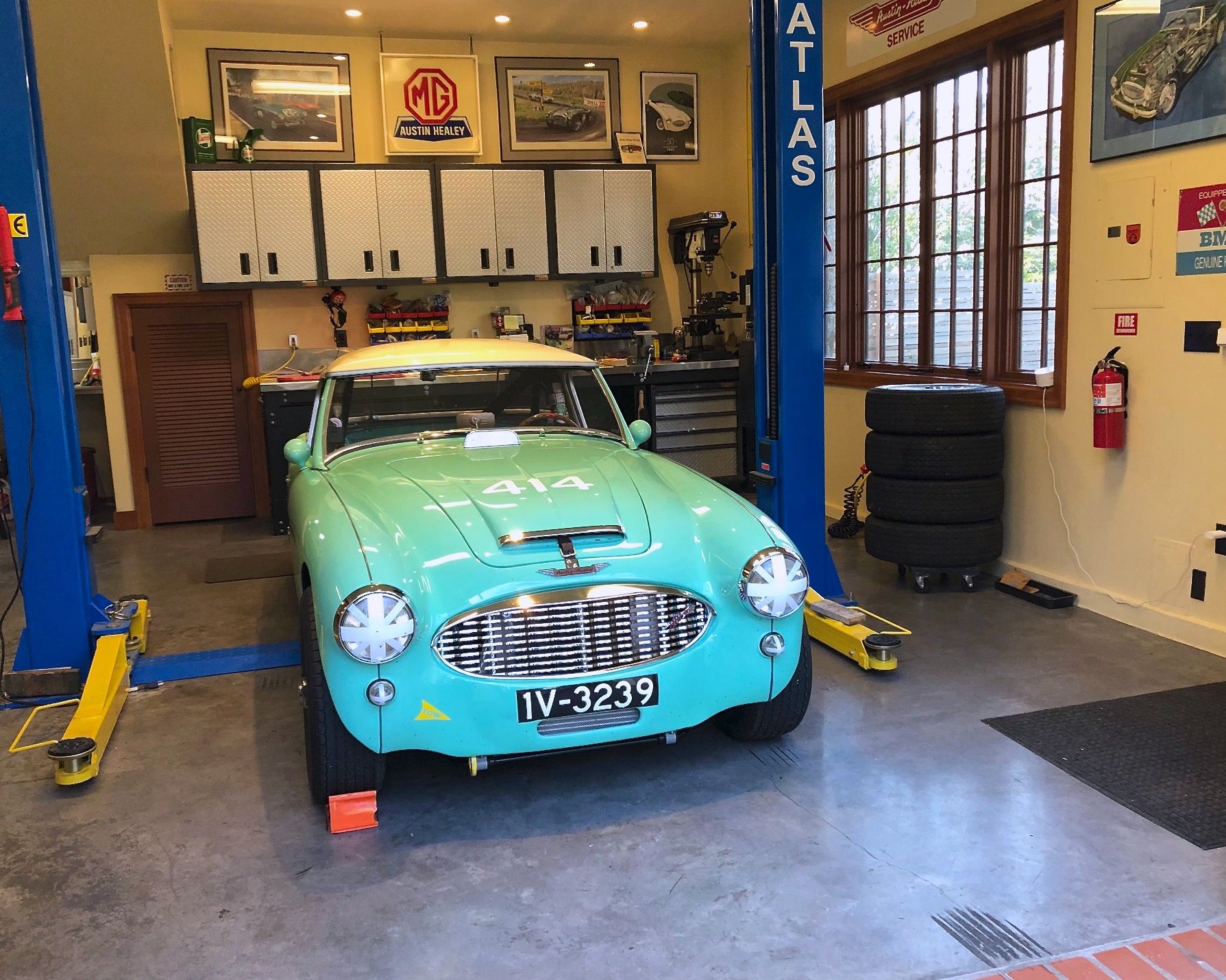

Any other racers preparing for you upcoming race season? What's your priority on the items that needing inspection?

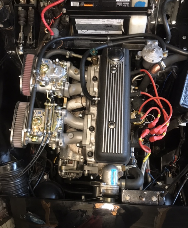

I have gone with an engine build.
New carbs, fuel pump, distributor, etc.

dougie don’t whatever you do polish it…
Doh!!!

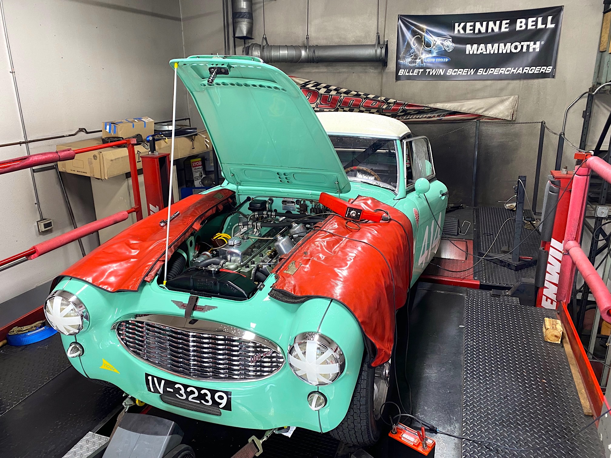

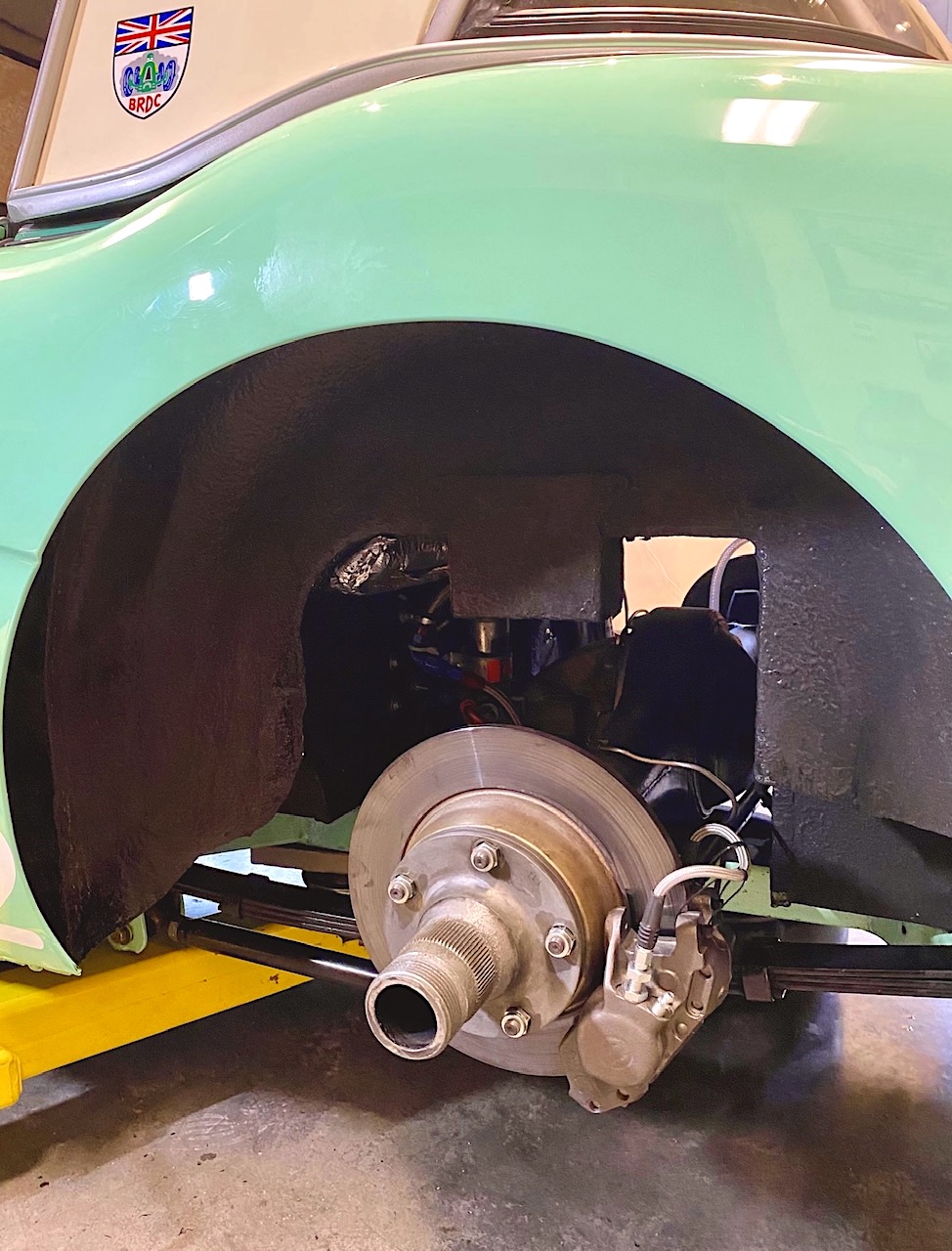

Full brake system service and complete rear Girling caliper re-build. In addition, some fine tuning on the dyno (rolling road) .......

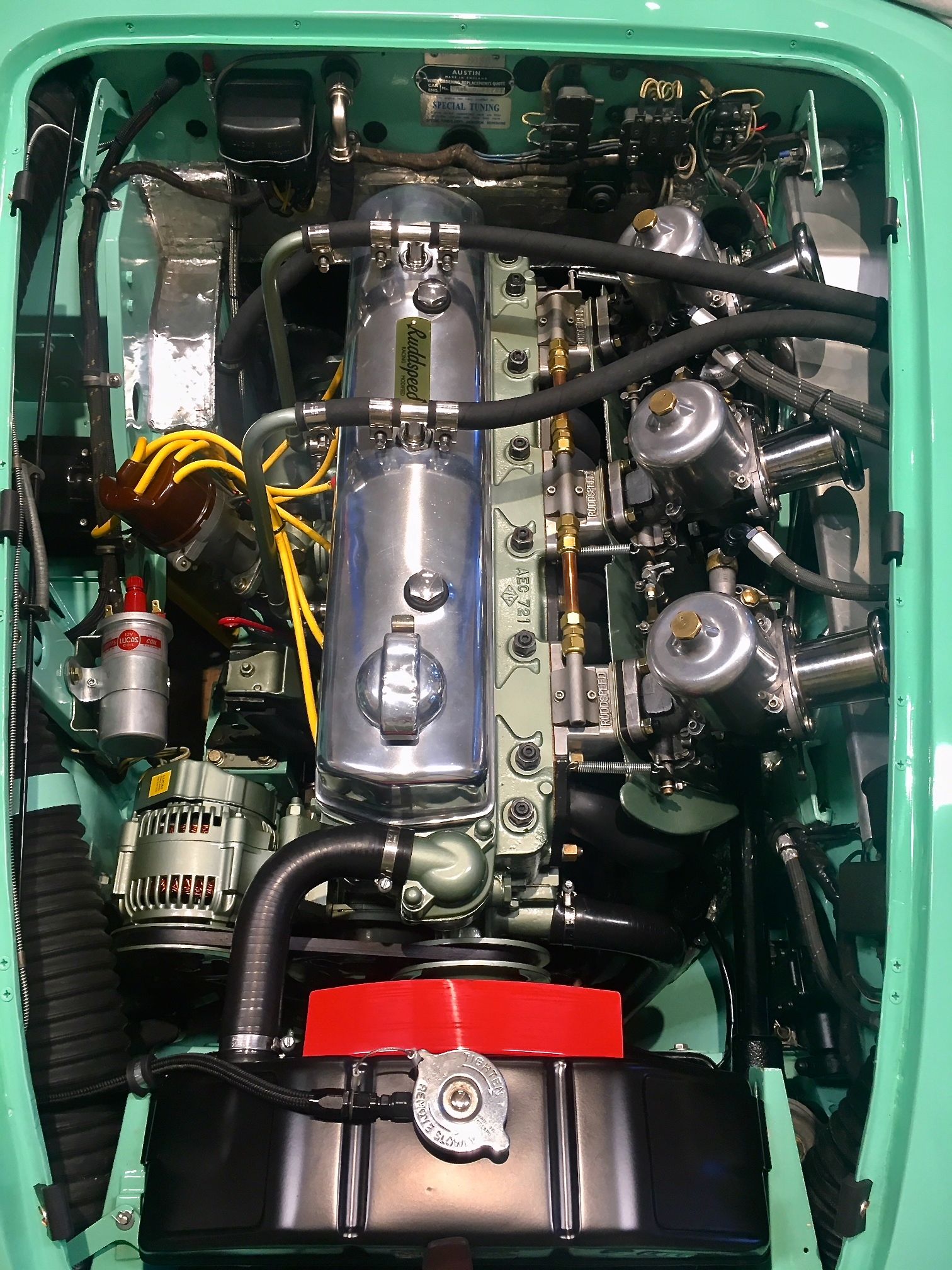

Fresh motor and after seating in the rings and taking a couple pulls to get the needles right with the triple SU HD8's and the new cam we still had the rev limiter set at a conservative 5800 rpm. After couple more pulls I was happy with 245hp and 260 ft lbs of torque with room to grow.
