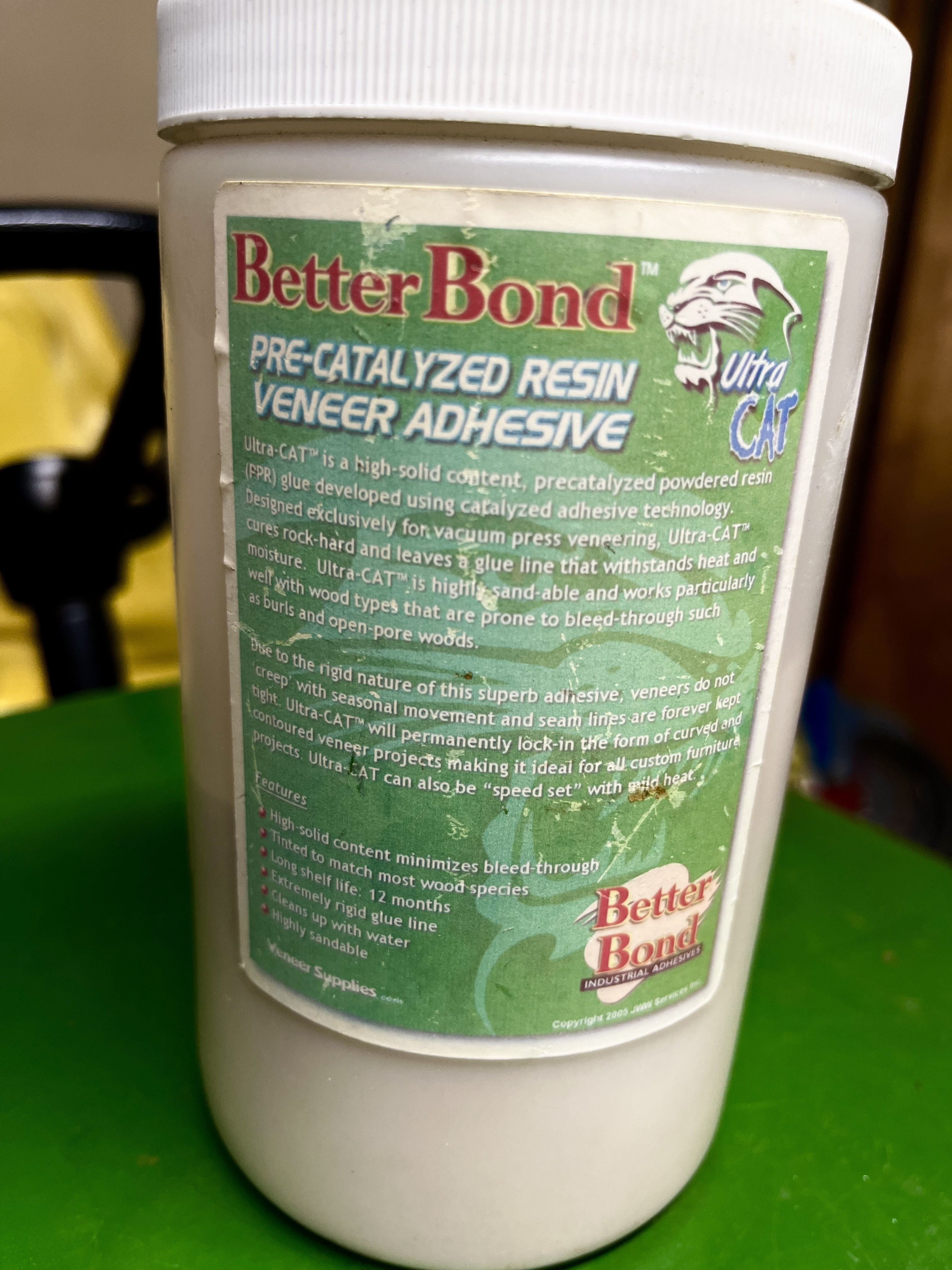

When I re-veneered my TR6 walnut dash about 20 years ago I used powered pre-catalyzed resin. It has held up perfectly.... no de-lamination what-so-ever. After applying, I used a press that I made to keep the veneer under pressure for 24 hours.
This is what I used...
