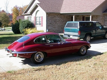

Steel wheels were optional on Series 2 E-types, and standard on the Series 3. The hubcap motif on the S2 was similar that found on the horn button, while the later cars used the gold Cats Head found on the seventies sedans.
40+ year old steel wheels are likely to be far more stable than the original wire wheels of the same age. Group 44, Gran Turismo and other race teams never used wire wheels because they were not strong enough, and steel wheels and alloys gave better handling. Old, original equipment chrome wire wheels are very likely to need replacement, as the chrome is usually pitted, and they are a pain to get balanced and stay balanced. So if you buy a car with steelies you have the potential to pay less for the car, and have a safer wheels that feel better on the road, until such time as you have saved your pennies to convert to nice new wire wheels, such as Daytons.
Regarding the 2+2, my highly biased opinion is that this is the sleeper E-type par excellence. As a daily driver the S2 2+2 is much easier to live with, with improved cooling, brakes, and more interior space. The S2 had more rake in the windscreen, which makes the design more cohesive. Most of all, these are the "affordable" E-types. For those of us with E-type taste but unable or willing to drop $30-50K, and climbing, on a coupe (never mind the OTS)the 2+2 with a manual transmission gives the same driving experience as its more desirable sisters. Looking out of the windscreen and down the bonnet, the view is much the same!

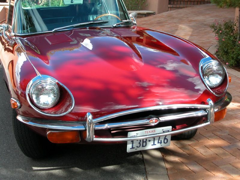

The Amco bar is shown below. It was a popular add-on back in the day, made by Amco, who supplied all kinds of after market goodies.
It was supposed to protect the nose, and could do so from hits by kids on tricycles, but it also had the potential to do more damage in a bigger impact. If hit hard enough it could fold in on itself and pull the bumper mounts out of the bonnet on either side.
