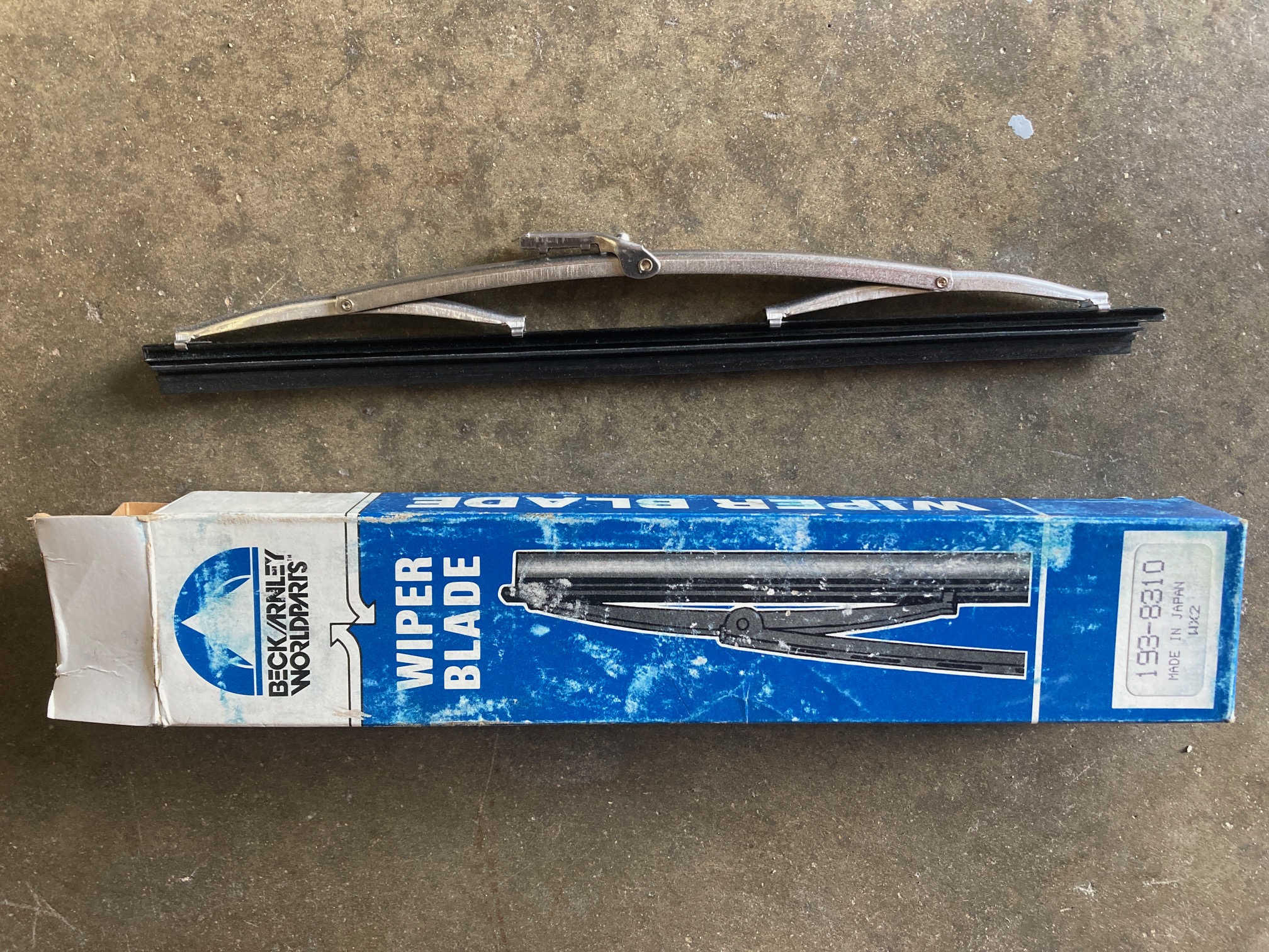

I once lost a wiper on my BJ8 on a road trip years ago. I managed to find a suitable replacement at a Napa store, except it was black (blade+frame only). A while later, I got a 'hot tip' from someone that RockAuto had a closeout on a Japanese-made wiper that was a perfect fit, and I bought, IIRC, a dozen at about a buck apiece (I think shipping cost more than the wipers).
