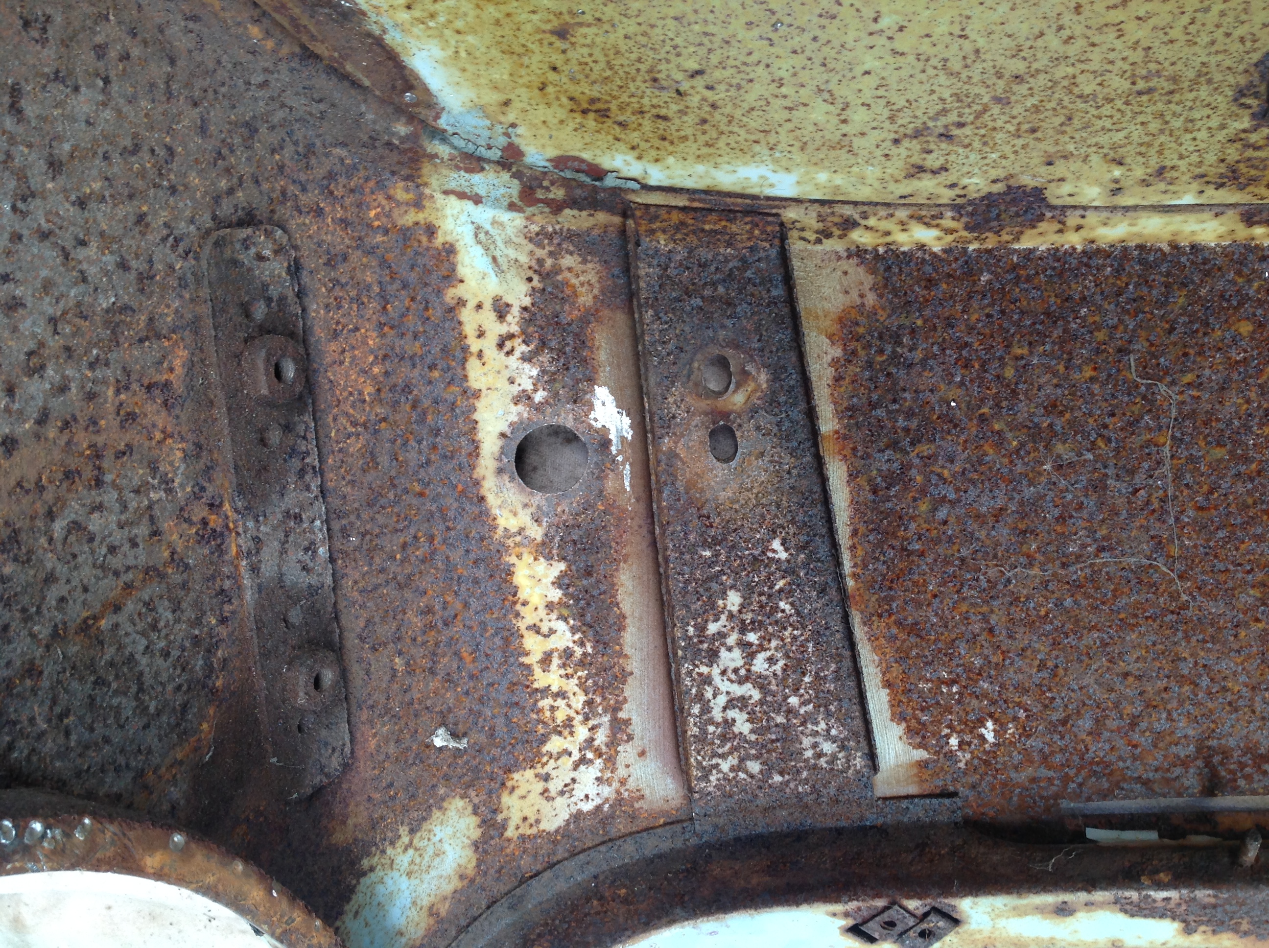

Inside the scuttle there is a flat plate with with two nuts welded to it. The whole assembly is spot welded inside the scuttle panel. I remade this section of panel and cleaned up the assembly and re-spot welded it to the panel. My suggestion would be penetrating oil from inside if possible, try and recut the slot with a dremel and the careful use of an impact driver. Failing that, you may need to drill out the bolt and re-tap the thread. Best regards, Lionel.
Thanks for the photo. If I can direct a stream of penetrating oil onto the nut and let it soak I should be able to loosen things up. I like the dremel and impact idea. (y) (y)

Have you seen the photo Lionel sent? This is what is on the other side of the stanchion. I do not see any issue in lubricating the nut that holds the stanchion screw.
