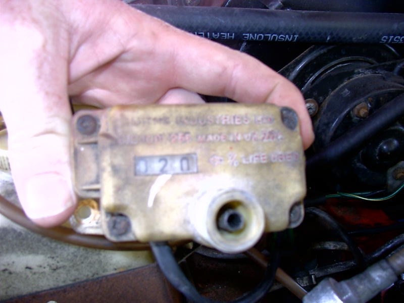

I posted about this a while ago, but don't remember getting a definitive answer. The writing on it says % Life Used and Smith's Industries. It is inline with the speedometer cable. How can a counter tell how much life is left in the engine? Wouldn't it depend on how well you maintain your engine?
See attachment

it was to remind you of service intervals, most of them went bad and have been removed
I'm guessing it is only counting the miles based on some pre-determined normal life expectancy. Say some magic number 100K+ before the owner can expect to rebuild the engine. But interestingly enough my B doesn’t have one, perhaps it was removed by a PO.
Anyway it’s intended use is probably no different than the modern computer in cars that monitor the hours on an engine (not just miles). That when serviced is simply reset either manually or in some cases using an OBDII code reader.

Thanks for the input. There is no reset switch on it for service intervals and it doesn't register miles traveled just a percentage of life left in the engine I guess.
Rick
Yup monitoring the miles alone isn't really that good of a way to track an engines life. Actual hours would be a better way to do this. But back then a simple mechanical setup like that probably seemed like the best way to do it without getting too complicated & costly ($$$).

That is a 'service interval counter' (SIC).It senses nothing but miles. At 25000/30000 miles (it's been so long I cannot remember) it turned on a light on the dash or console. MGB's have an 'EGR' light . Other LBC's something else. Anywho , that is what that light that you have not seen illuminated is for. It is hard-wired into the wiring harness which is why you will find most of them cut. At the dealer , we reset it with a paper clip. You will see a paper clip size hole on the side of the SIC. All it is telling you is that it is time to check the emissions system.

Thanks for the info. I'll look for the paperclip sized hole. My EGR light does come on when I start up the car.
