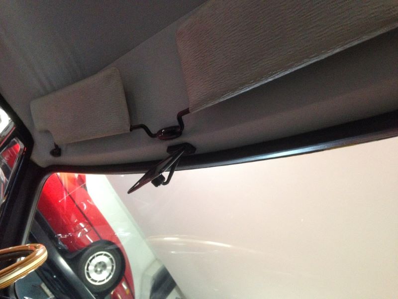

I found replacing the two (upper and lower) windshield frame rubber gaskets to be very time consuming and difficult. The headliner covers the top bolts attaching the frame to the roof and the dash pad is in the way of the lower gasket going between the cowl and lower edge windshield frame. Trying to align and not pinch or tear the rubber while installing was trying.
