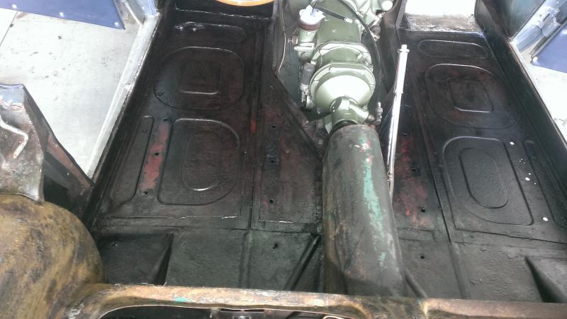

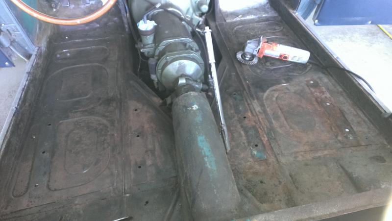

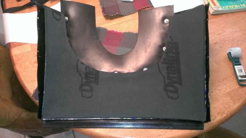

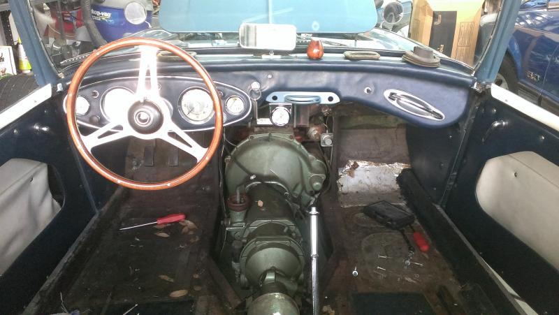

Today I removed the rusty heater and used a rust converter SEM's rust sealer on everything under the dashboard and insulated the firewall with Thermo-Tec's cool-it heat/sound dampener.
It wasn't easy but feel it's going to work great plugging any holes and insulate.
That was just todays project, the past three days I have been preping the car for a new carpet. This project keeps getting more involed as I see things that need to be done and figure I might as well do it right the first time.

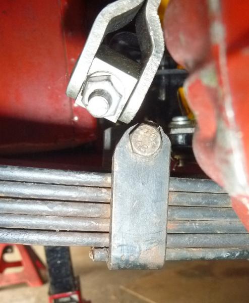

I changed out my rear axle oil for Red Line MT-90 and discovered how easy it is to pump. Removed an extra leaf I'd installed in each rear spring several years ago and discovered my Jag e-brake levers now hit the spring shackles, which had to be cut away slightly.

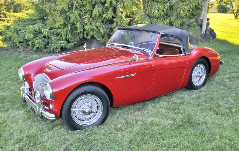

I took delivery of a one-owner, all*-original BN2 that I bought yesterday. Actually it's in my brother's garage in Spokane as of this morning, and I'll go retrieve it (to Portland OR) this weekend. Details later.

Are those British Plates on the BN2? Nice car,Reid.
