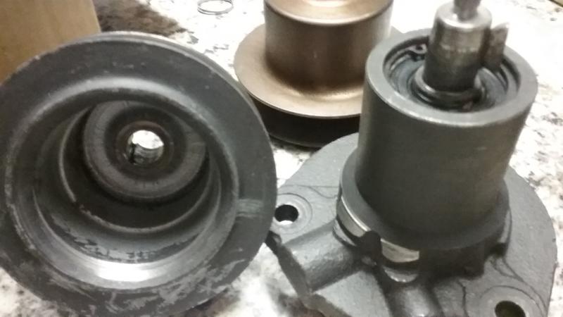

Installed one of those up rated water pumps from Moss when I installed the engine. In the past i remember reading posts where there were problems with the pumps. Horror stories where pulleys were coming off and going through the radiator. Herd some strange noises under the bonnet tonight and was watching the engine run and noticed a pretty good wiggle in the water pump pulley. You can actually grab it and wiggle it and I din't notice the shaft moving ether. So the pulley must be loose on the shaft. Tried tightening the nut and it's tight. The pulley is the original that came with the car so are they compatible?. What could be going on?

Got it all apart today. The pulley was definitely walking around on the shaft. You can see the scuff marks on the pump body and the inside of the pulley. I'm so fortunate that I have this resource here but went to Team Triumph this morning and bought a new pulley and wood drift key. As you can see in the pics I had the same problem as Charley. The new key was larger then the shaft slot but fit perfectly in the pulley. However I didn't take mine to a machine shop I just used my Dremmul tool and my grinder to alter the shaft slot and key to fit the shaft. Took over an hour to get it perfect. Just for some piece of mind I epoxied the key into the shaft. All is running now. I figured out the clutch problem one another post.
