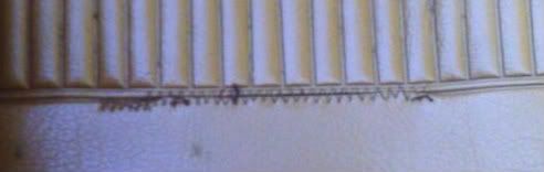

If you're cheap like me and just want a quick-and-easy fix instead of goopy stuff; I used upholstery thread to <span style="font-style: italic">sew </span>the tears up. (Use a piece of scratch vinyl on the backside to sew to, so the thread doesn't rip out.)
Here's some of my needlework...
The repairs were less obvious when it was black-on-black, before I re-dyed the seats. I don't mind it; sorta gives the seats provenance. :jester:
Yep. Had the standard black all the way through. Looked like the Black Hole of Calcutta. Dyed the whole thing, and it's much cheerier now. :banana:
