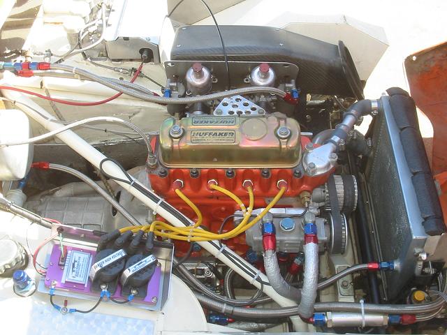

Here's a picture of the Huffaker Bugeye I drove a few years ago, it had a Ron Davis cross flow radiator. Maybe this will give you a few ideas.

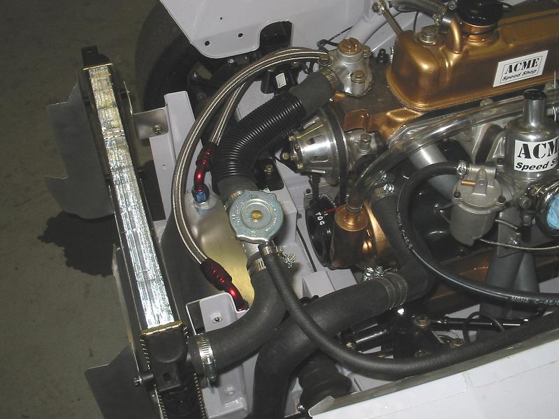

OK, now here's another way to skin a cat, while I get to play with alot of cool stuff that belongs to other people, on my dime I accomplish the same thing for a fraction of the cost on my own car, and some of my customer's cars. This is a crowflow VW rabbit crossflow radiator, Valeo brand, aluminum center core, plastic side tanks, weight like half what the aluminum radiator weight at 5lbs. Used a Moroso filler neck, and got the hoses at Advance auto, cost about $150 total, compared to the $600 Ron Davis set up cost.
I weld a 1-1/4 neck onto a Spriget 1" termostat housing and made a 1-1/4 to 1" reducer for the water pump. Best cooling radiator I ever used, yes even better than Ron Davis unit, very popular route with the SCCA spridget guys. I'm doing to run this same set up on my vintage car.
