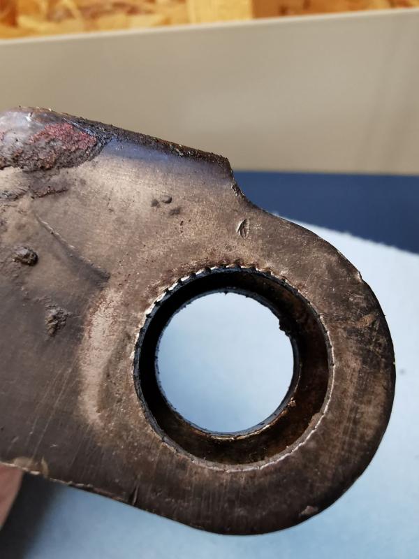

At any rate, I was able to lift the arm up enough to get a long box end wrench on it and free the nut. Now that the wishbone is off, I see that the splines are worn on the hole for the ball joint.
Is this critical for reassembly?
Cheers
Bob
Never been sure if those slots were made by the ball joint or they come that way new. The new ball joint will have the splines and they will cut into that thin metal. I do not like many aftermarket parts, so I would use that one unless you have a better one. I mock up the whole assembly and see how everything works as a whole then move that to the car. The wishbones overlap sometimes better one way than the other. The inside of the wishbone where the rubber goes is often pitted; what I do there is clean the inside high spots up with a file or something, but not too much and go with that. I have good success.
steve
+1...the splines are from the ball joint as it holds itself from turning. You are fortunate, as I have had the ball joint turn as it came off before, and that opens allows the spines to open up the hole so the arm cannot hold a new ball joint. But you are good to go!
remember, the splines are actually on the ball joint post, not the A arms. What you see in the arms is the result of the ball joint splines biting into the arms. The new ball joint will cut it's own new "splines" into the arms.
