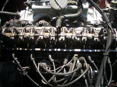

Can you take of picture of the rocker assembly so we can eyeball how you assembled it?
Here is a pic of the rocker assembly itself.

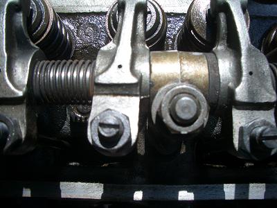

And here is a close up showing how dry it is. I can actually hear the valves go out of adjustment after a couple of miles. When this happens the oil pressure goes down too to about 25.

That does look pretty dry. Might be worth pulling the assembly apart, make sure the bore is clear and the holes are lined up.
OTOH, I had a TR3 that had been assembled wrong, so the rocker shaft got no oil at all. The pushrods were literally rusty! But it ran pretty good that way, for several thousand miles at least (I bought it near Houston & drove it home to LA).
seems like the OP would go up a bit if it stopped feeding the rockers. Maybe the low OP is the real problem.
Did you have your head shaved ?
as I noticed that the adjusters were showing quite a bit of thread above the locking nut
Thought about the OP also, but before the valves move it stays between 50 and 70. Also, before I burned the valve, the oil pressure was fine. I am going to take the rocker assembly apart and see if anything is blocked as suggested. How is it possible to put the rocker shaft in wrong? How do you know if you have put it together correctly?
On the rear most pedestal, there is a hole on the passenger side . Line that hole up with the hole in the rocker shaft and insert the philips head screw to keep the shaft lined up so the oil holes are oriented correctly.
You said you installed a rebuilt rocker assembly ... generally the shaft is replaced during a rebuild and the replacement may not have been drilled correctly.
If I recall correctly, the TR6 shaft has plugs in the ends that can sometimes get dislodged as well.
I don't see any way that oiling to the shaft (or lack thereof) could cause that kind of pressure drop. Sounds to me more like something is too tight, and binding when it gets hot (like maybe the exhaust valve stems binding in the guides). The OP is also dropping from the heat (thinning the oil plus too much clearance somewhere).

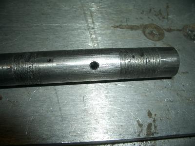

Well, more bad news. I took off the rocker assembly and 7 out of 14 rockers are basically frozen now. I know why the rockers felt like they were sticking when I tried to adjust them now. I have included a picture of the shaft below showing some of the damage. I cut the shaft in a number of places so that I could get what I could off of it without harming the good pieces. Could this be the result of no oil after only about 12 miles total? I have a used rocker assembly off of another TR6 engine (only a few serial numbers away from mine) to compare everything to, and I did assemble everything correctly. I have had enough tonight, but I will check to see that oil is coming out of the ports under the pedastals in the morning. If that works, I am going to put the used assembly on and make sure oil is moving through the individual rockers after I adjust the valves and see what happens.

No matter what you do with that shaft and replacing it is the only thing to do, along with the rockers, you still have to make sure you are getting oil up through the head or this will happen again.
Ouch! IMO something worse than just lack of oil was going on there. Shaft too soft, rocker bushings too tight, something like that. And it happened in just 12 miles?! Just the assembly lube should have worked for 12 miles.
I would pull the plugs, and spin it with the starter (rockers still off) until the oil pressure comes up and you get flow from the hole in the head. It can take some time, and the flow won't be very strong, that's OK. But if you don't get oil coming out of the hole, there are deeper problems that you're going to have to fix.
