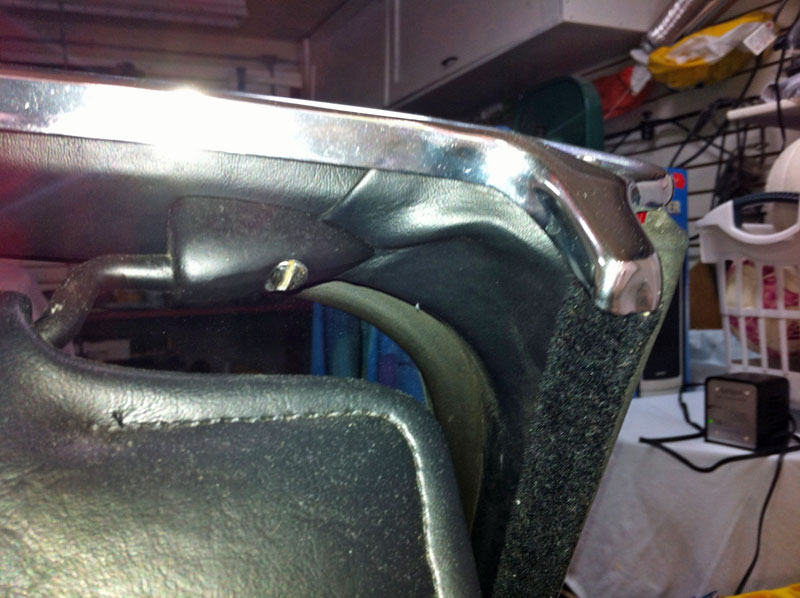

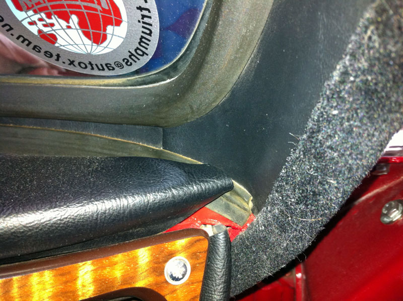

OK, here are some pictures. On the top, you can see it is just poofed out a bit, looks worse in the picture than in person. I think it the seam was more toward the vertical, it would be a little easier to get to lay flat, as well as not being right under the sun visor mount.
On the bottom, you can see how little actually shows once mounted. I also need to get that corner of the crash pad to stay down!

moe_morin said:
...Not sure where/how the pieces meet or overlap. I've been trying to find a picture of this detail, but no luck so far...
Here are some pics of my TR4 which has the original trim. It appears (from the overlaps) that the 4 pieces were fitted in this order: bottom, 2 sides, then across the top.
