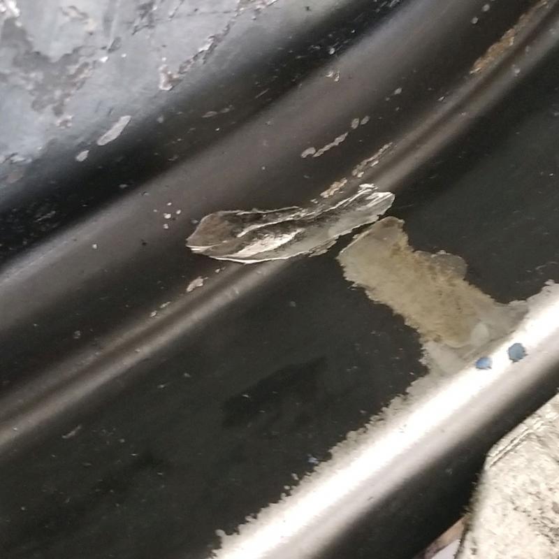

Check the inside of the timing chain cover where the tensioner pushes against the cover. On mine there was a lot of wear from the end of the tensioner. I welded up what was shortly going to be a hole.

When I did my first engine on a TR4a engine I neglected the whole timing chain area. A hole appeared in the cover similar to the picture shown. Got a used cover from Fred Petroske (sp?, anybody remember him?) in New York, and a new chain and tensioner from the Roadster Factory and got many trouble free miles after that. If the teeth aren't pointy or showing signs of wear I would leave them but I am very much a if it ain't broke type.
