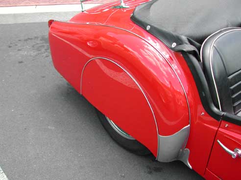

Here's a photo of Ralph Eriksen's TR3 with spats. I don't know if they are original or reproductions, but I would guess reproductions.
I like that chrome bit, it really sets it off nicely.
Nice photo -- but I think this is like wearing a cowboy hat or a cape -- some guys can do it and look good -- on others it just looks goofy.
Geo,
Good analogy, I feel very comfortable in my cowboy hat but always felt a little showy when wearing my cape.
The same color beading would have a finished look too.

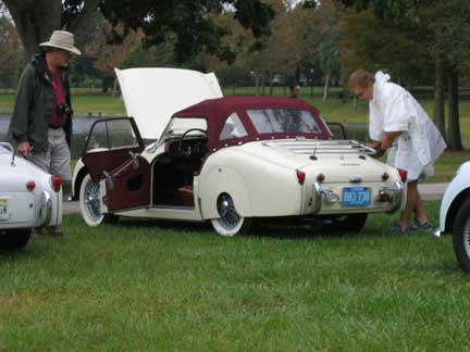

Randy, you are correct about TR2s having "dedicated" hubs for wire wheels as opposed to the adaptors used later, but that doesn't help with the clearance. It's the up-and-down motion that one needs to worry about, and the knockoffs will extend out to or even a bit further than a skirt. Odds are one big bump would be enough to destroy even a skirt with a cutout. If you look at pictures of, say, various older Jaguar saloon cars, you'll see that those with knockoff wire wheels do not have skirts.
Hard to tell for certain at this angle, but it looks to me as the knockoffs on this car do protrude well out into where the skirt/spat would be:
Twosheds said:
I have seen spats that are cut away to clear knock-offs, though.
